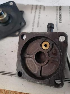

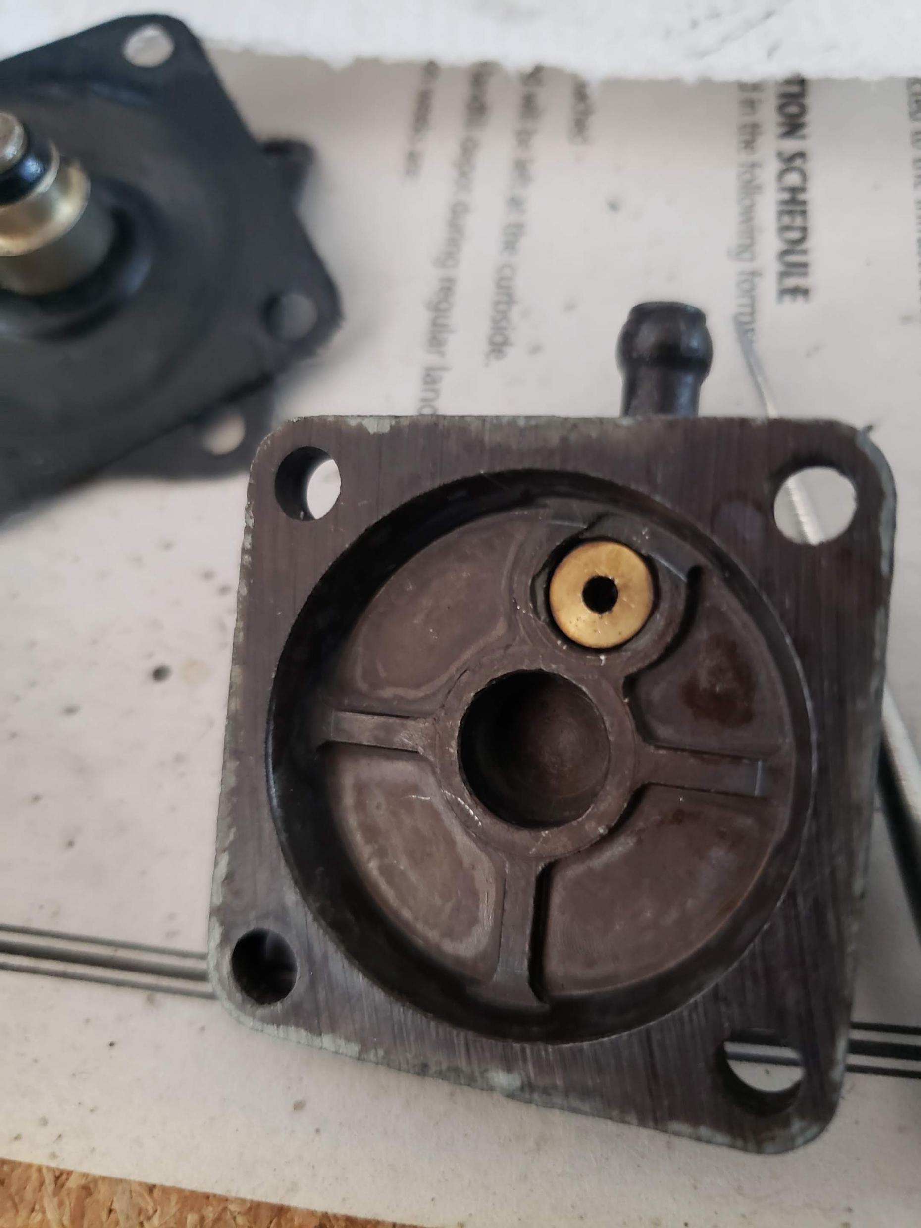

                  I'm rebuilding mine on a standard. Sorry to hi-jack, but this thread has the petcock people's attention and I want to ride!
                  Does anyone know if the little brass plug cylinder need to be loose in the cylinder? One side fell out, I cleaned and put back. The other side is stuck in there. Click image for larger version

                    I can't wait. Just tried blowing through it, seems to be a one way valve, so I'm proceeding with it. Besides, it worked before. Thanks for the help!
