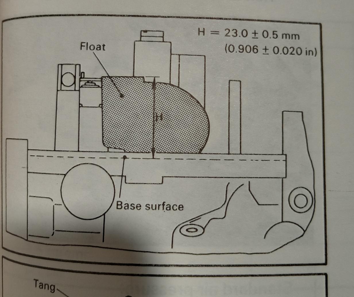

    ive got a 1979 xs1100 thats been setting for a year or so, i pulled the carbs and cleaned. i couldn't get the pilot out of # 2 carb so i got one on ebay. i put them together and ran gas to them. all was good except # 2 was overflowing. ive changed everything but didn't help. with out gas the carb seals off, you can blow in the gas line with the carbs up side down and no air will go through. ive trimed the gaskets, float works good. the carb has the black plastic floats, i set them on 25.7mm i read that they should be set on 23.0mm ive got the early carbs is that wright. could that cause them to overflow? thanks
    • 8767
    ​​​​​​Plastic floats in early carbs should be 23mm with gasket removed. I don't think the 25.7 mm setting would cause the flooding, something else going on there. Make sure to check both sides of each float.
    Click image for larger version  Name:	IMG_20230124_171748~2.jpg Views:	0 Size:	136.9 KB ID:	872277
    When you're filling the carbs, tap on the #2 carb bowl and see if the problem persists. Is the ring gasket on the float valve in good condition?

      If possible take a couple pictures of the carbs and post. Best if you can take the bowl off #2. Black floats generally don't say early carbs. Most of the early carbs had brass floats in them. Phil's picture shows how the float heights should be measured and set.
