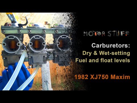

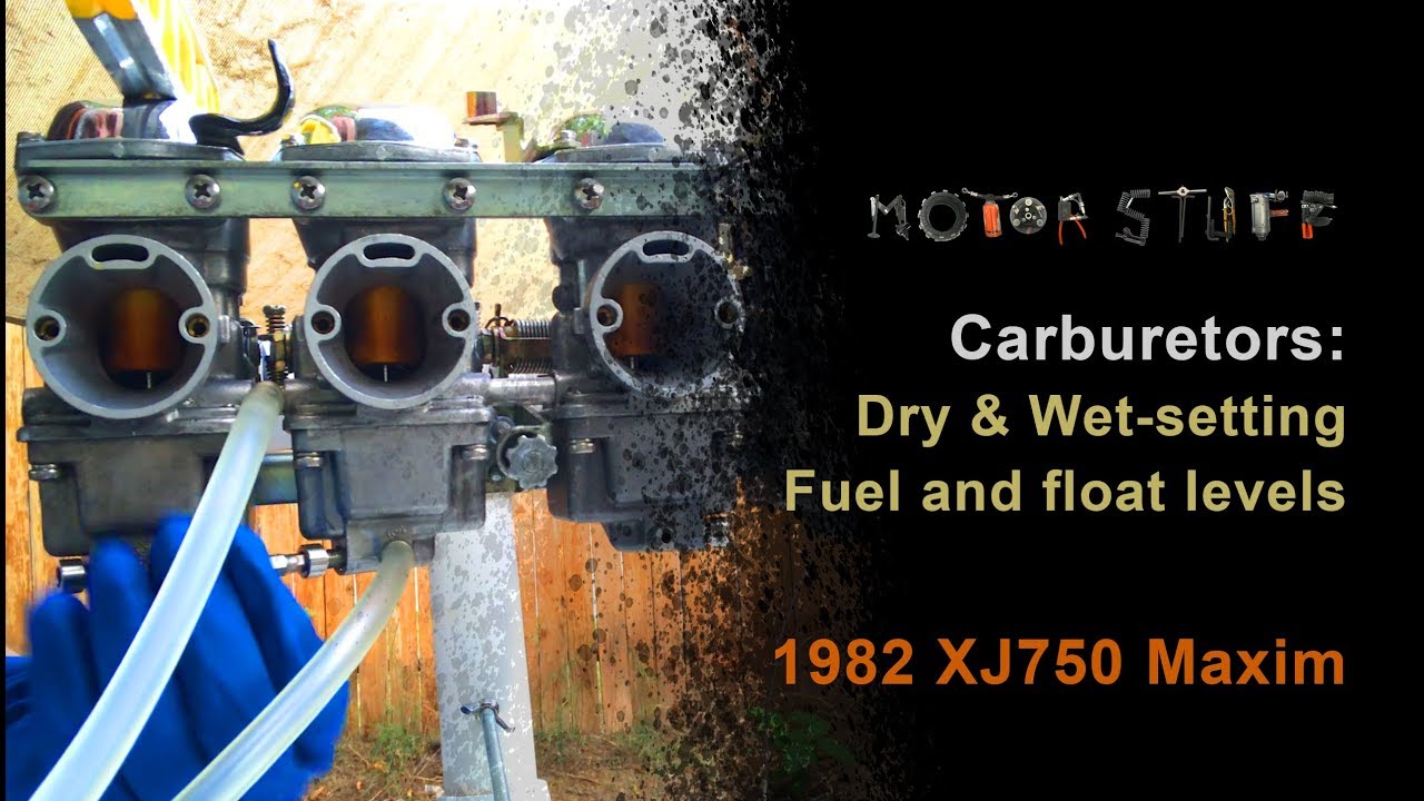

    A few years ago I saw a rig that a guy made out of PVC pipe that allowed him to set his entire carb rack into it to make float adjustments without having to mount them back onto the engine. Basically it was a straight section with four tees and a stubby length sticking out of each tee and some pieces of universal type radiator hose to clamp the rack to it. Seems like that might be some to consider trying seeing all the headaches you're having.
