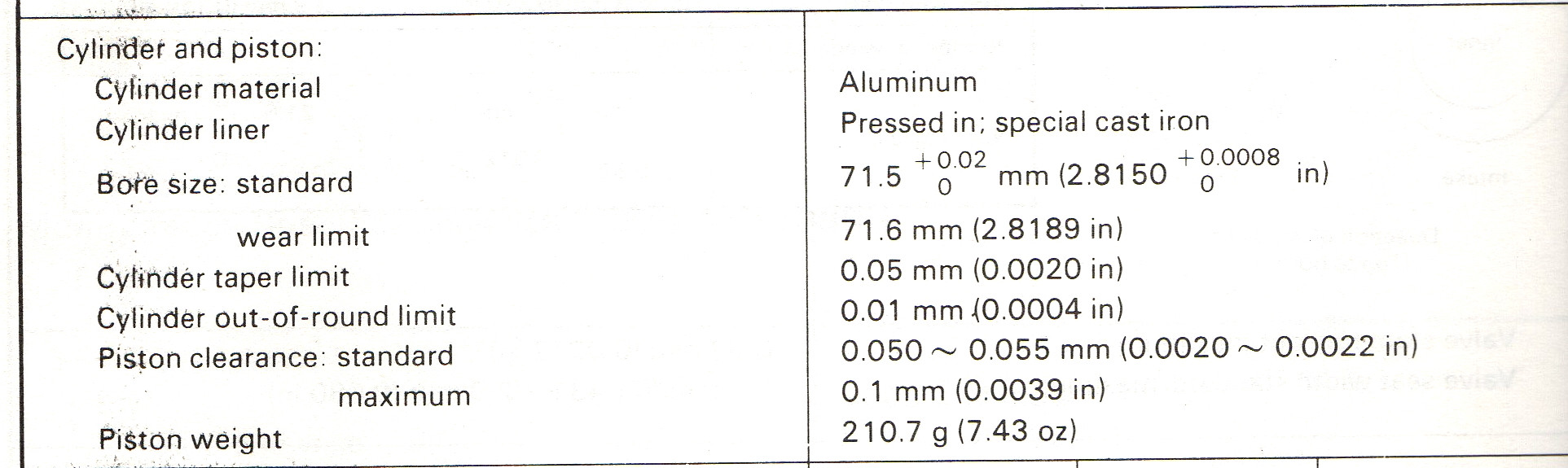

    Hello friends,
    I have an xs1100 engine currently being built at my local machine shop. The machinist is asking me for the factory piston to cylinder wall clearance. I don't have a factory service manual to look that up. Does anyone happen to know?
    Any help would be greatly appreciated.

    0.050 to 0.055mm is factory clearance.

ID:	871285 Scanned this from my Yamaha service manual, if it helps.

        Ah, but what year is that for? I looked up the '80 in my manual, as that is what his signature states he has.

          You are absolutely correct Mr Ray! Thank you for catching my error. Good eye...
          I went back and checked the SG supplement in the back of the manual.
          The edited correction has been made to my original post.
