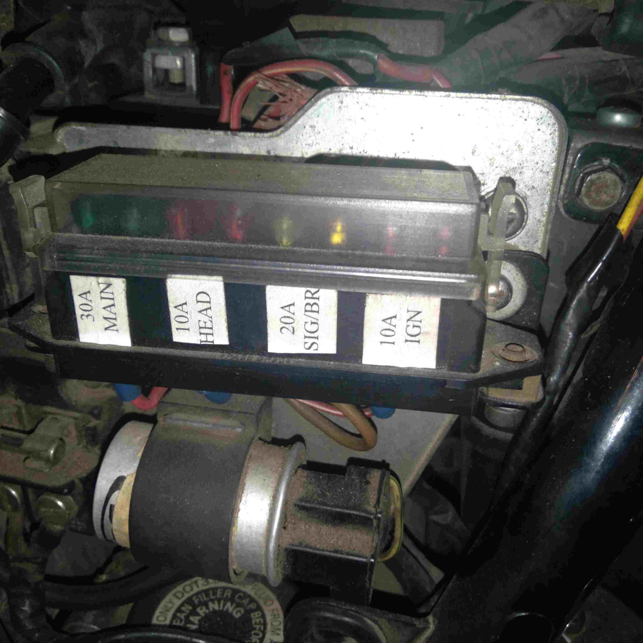

                        ok so how did you replace your fuses. Mine is falling apart and one fuse only has an ear on one side. As much detail as possible please.
                        I’m still running original coils but have replaced the plug wires from them. Jeff

                          thats a job i still need to do, a full fuse holder change. my main fuse had a broken ear so i just cut the ends off and soldered a single in line fuse holder for now.

                            I used an 8 gang fuse holder so I have a spare fuse for each circuit. Search around, they have different ones that you might like better, different the way the spades are located. And of course I used printing labels to label each circuit. You will have to make some type of mounting bracket, it can be very thin metal. I also suggest you replace your coils, just my opinion. https://www.summitracing.com/parts/h...xoCBg4QAvD_BwE
