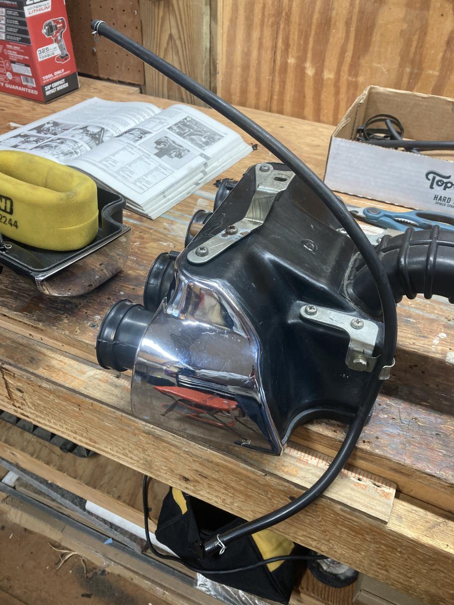

    About to reinstall rebuilt carbs--quick question about the vent hose that runs from the rear of the tank--where should it route after going through the clip on the left side airbox mount? There is a wire clip on either end, and I get that the one is used to attach the hose to the nipple on the tank, but not sure about the other end. I would've thought it just vented to the air, so not sure why there is a hose clip on it.
    Thanks all!

    The wire clip on the bottom does not belong on the hose. The hose goes through that clip, and in the frame you will see a welded wire on the swingarm boss. hose goes through that and stops about two inches below it. That hose drains water that get into the gas cap area of the Standard fuel tank.
      • 7830
      Just thought of something else it may be! There is a vent hose for the middle drive that goes up under the seat/tank area. Open at the top, no clip, but clip at the bottom. Keeps water out of the middle drive so you MUST use it! My LG didn't have it when I first got it, and I almost lost the middle drive because of that.
        Thanks Ray, that confirms my instinct. I fired the bike for the first time over the weekend, and she fired right up! Seems to be an oil control issue to resolve, primarily in #2, so more to do however...
