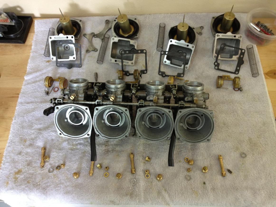

        I agree with above. Manual details how to adjust float bowls. It’s easy once they are off the bike. You only need to remove the bowls. Second issue could be the new fuel needles are not seating/sealing. I’ve had new rebuilt parts fail.
        Also, I have had to tap the side of the bowls.
        if all carbs seem to have been spewing fuel, I would guess floats are not adjusted correctly. It’s probably time to become intimately familiar with the carbs. I’ve had mine apart so many times I’ve lost count. For me hardest part is wrestling them off the bike.
        during any work on the be sure and keep parts separate for each carb. Never intermix them.
        Good luck. Jeff
        Jeff Korn
        Original Owner 79XS1100 E
        • jkorn
          • May 2003
          • 188
          • Wickenburg AZ
          Like this example
