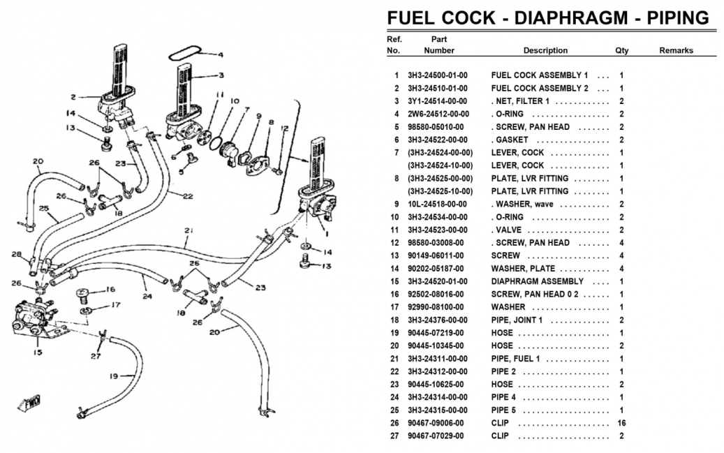

        Thanks gents. My apologies for my XS ignorance, ....so I see that it's easy enough to run vacuum lines back to #2 and #3 and keep the vacuum petcocks I purchased, but what was the purpose for the original octopus diaphragm and cock piping, which I do not have? Is that what is meant by bypassing the Octy?

            The Specials have manual petcocks. The vacuum shutoff valve (octy) is a safety device to stop fuel flow if the engine stops running. The standard XS11 has no need for this as the vacuum petcocks do that function.

                      The Special does NOT have a vacuum petcock. It uses the "octy" as we call it, for the vacuum switch to keep the fuel off when the engine is not running. Because of this, the Special petcock has two fuel nipples on it, not one. The front nipple is for the "prime" only, and is piped so that in prime fuel will bypass the octy and flow to the carbs. By blocking the prime nipple, no fuel can flow in prime so that does not need a fuel line. The petcock also has main and reserve, so just use those, and switch to the off position when parked.

                        Thanks Ray, now I get it! The Octy on the Special was essentially and “satellite” vacuum instead of having the vacuum diaphragm on the petcocks itself. What was confusing me was that I didn’t realize that the PO had replaced the petcocks with manual ones but with only one nipple. I thought that they were originals for the Special. Now I understand that I cannot plug my new vacuum petcocks because they needs the vacuum. At least now I have the choice of either keeping the new vacuum petcocks and running
