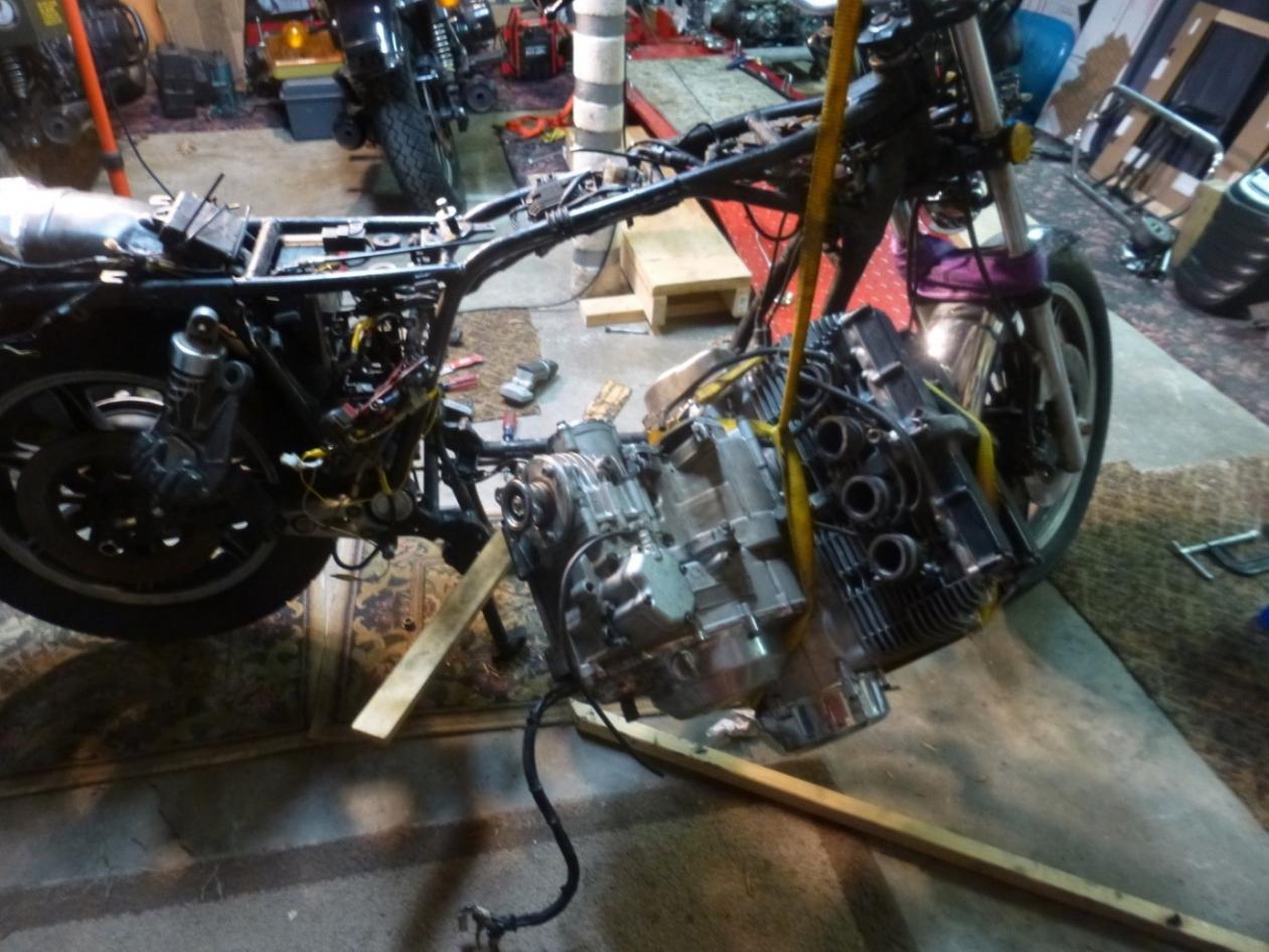

        • 734
        Hope this helps.... I hang a come-along from the garage overhead beam. Then wrap a strap around the engine and crank it up just enough to take the engine weight off the frame. After that it's a combination of wiggling the engine out of the right side and/or moving the bike frame to the left as needed. No heavy lifting required, just some moderate pulling and tugging and sometimes a little guidance with a piece of wood. I then reverse the come-along and lower the engine down onto a 4 wheel dolly. I've done this 3 or 4 times by myself.
