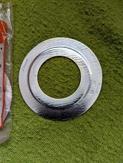

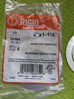

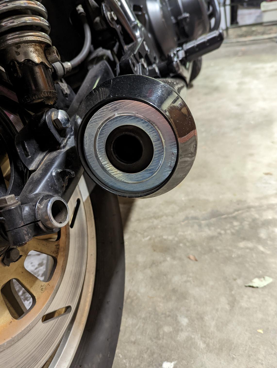

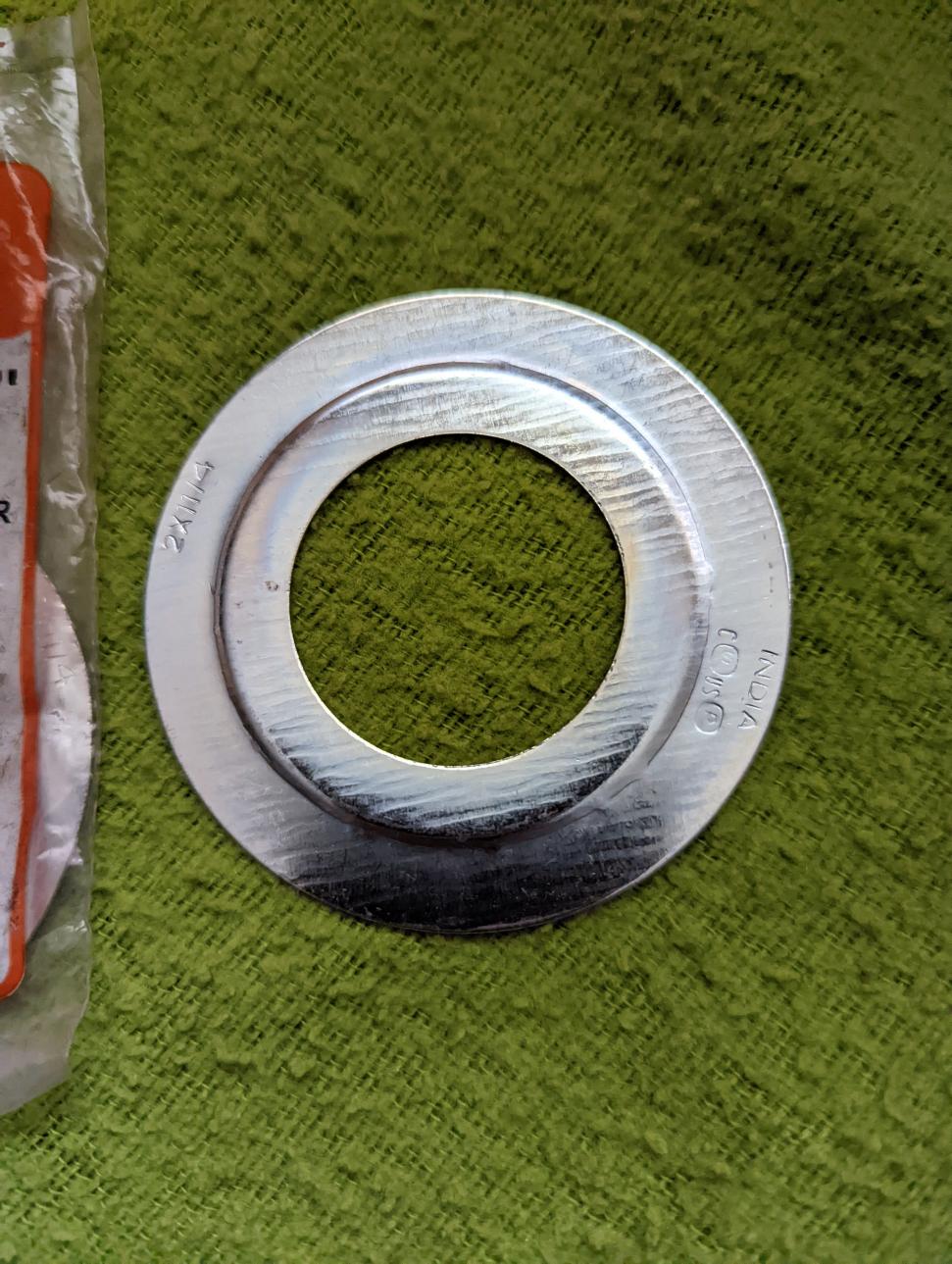

          I have zero welding skills so instead, I found this pack of 4 at Home Depot for about $2.00.... I can't remember if I used a high temp sealant or JB Weld under the washer before pop riveting it in place to cover the holes. It was an inexpensive, quick, easy, and effective solution. I also think it is a good idea to paint the washer. In my case I painted it black. It not only quieted, but also restored the power loss.

              Thanks for the suggestions everyone! The holes in question are literally 1/2 inch each, so I think I'm going to attempt to cover them with Ranger's conduit washer, we will see where that gets me

                That's just brilliant!

                    So I finally got around to plugging the holes, and Ranger's idea worked a treat! Now I have noises I can actually hear that I have to fix, specifically something that sounds like a chain being dragged across the ground, so that's exciting, as well as re-syncing the carbs and idle adjustments.
