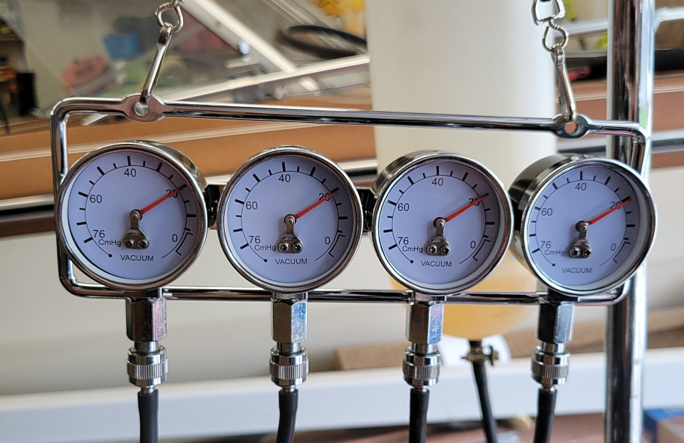

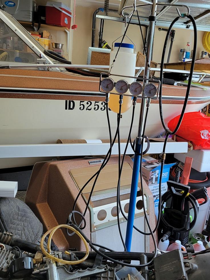

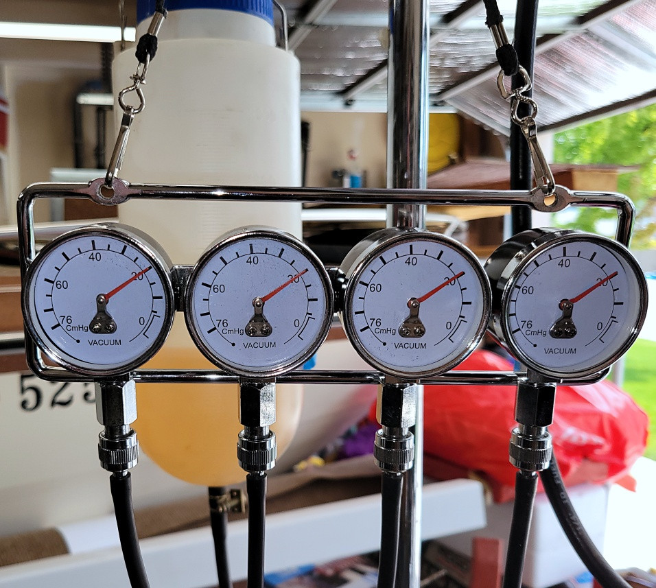

                              Carbs back on, check gauges, and synced! Should have the Special tank on Tomorrow, as I only need two "O" rings.
