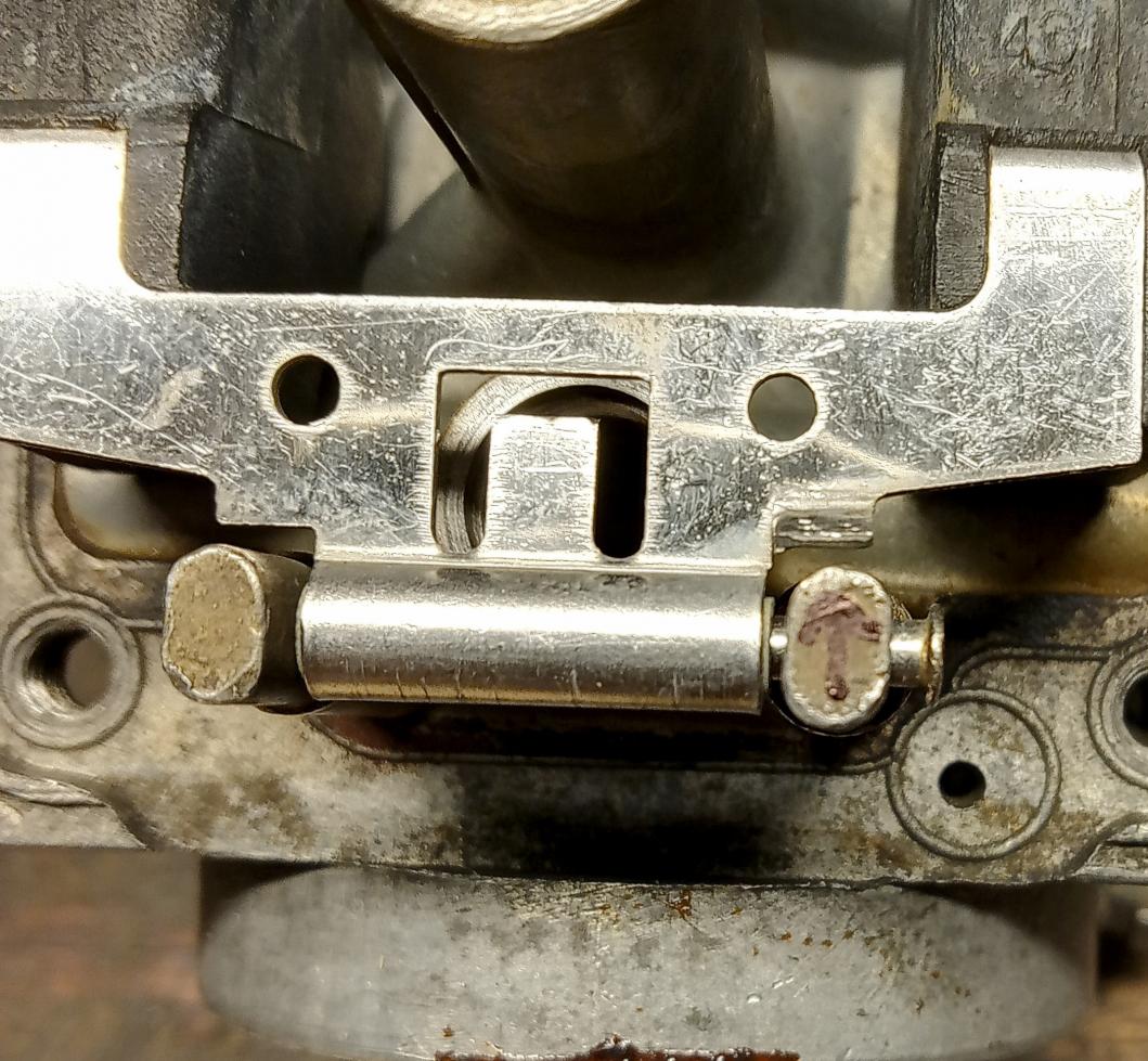

                          It seems to take forever for the float bowls to empty after I shut off the petcocks. The petcocks stop flowing after I shut them off. They were rebuilt by Pingel maybe 2 years ago. The bike will shutter but still keep running and I can see fuel in the lines. Is this normal? When the bike is running gas is not dripping after I shut it off and rapped on the float bowls with a screwdriver handle. When the gas is turned back on its fine.
                            Try adjusting the float drop tang. Bend it slightly so the float(s) don't drop so low when there is little or no fuel in the bowls. When they drop too low there is a chance of the needle getting 'cocked' in the seat. The metal clip can also get hung up causing the fuel not to shut off. Tapping the carb bowl usually straightens it out.
                            The float shouldn't need to drop more than 1/8" to let an adaquate amount of fuel in without it binding. Click image for larger version

                              One thing I always wondered how the clip on the float needle is supposed to be. Does it matter? Open end facing bowl?
