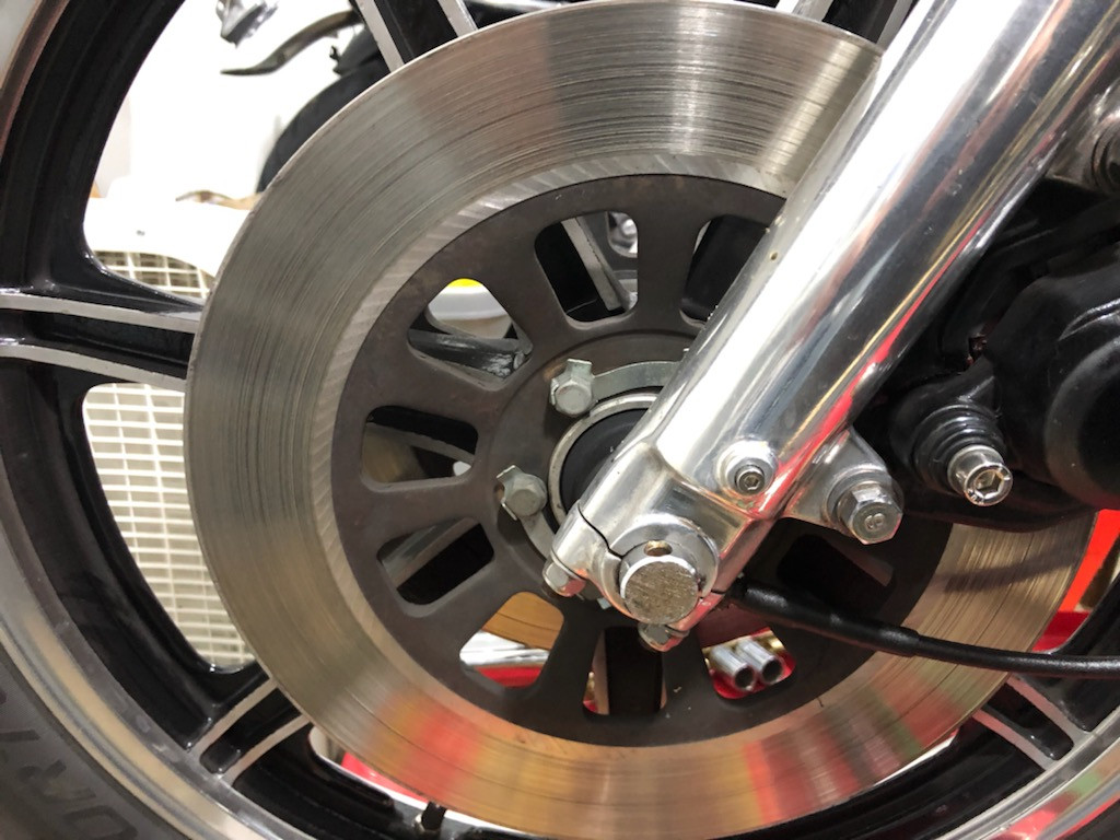

        Those rotors look right for the year but someone painted them gold like MNS rotors. That bike looks familiar, where did you pick it up?
          • 2104

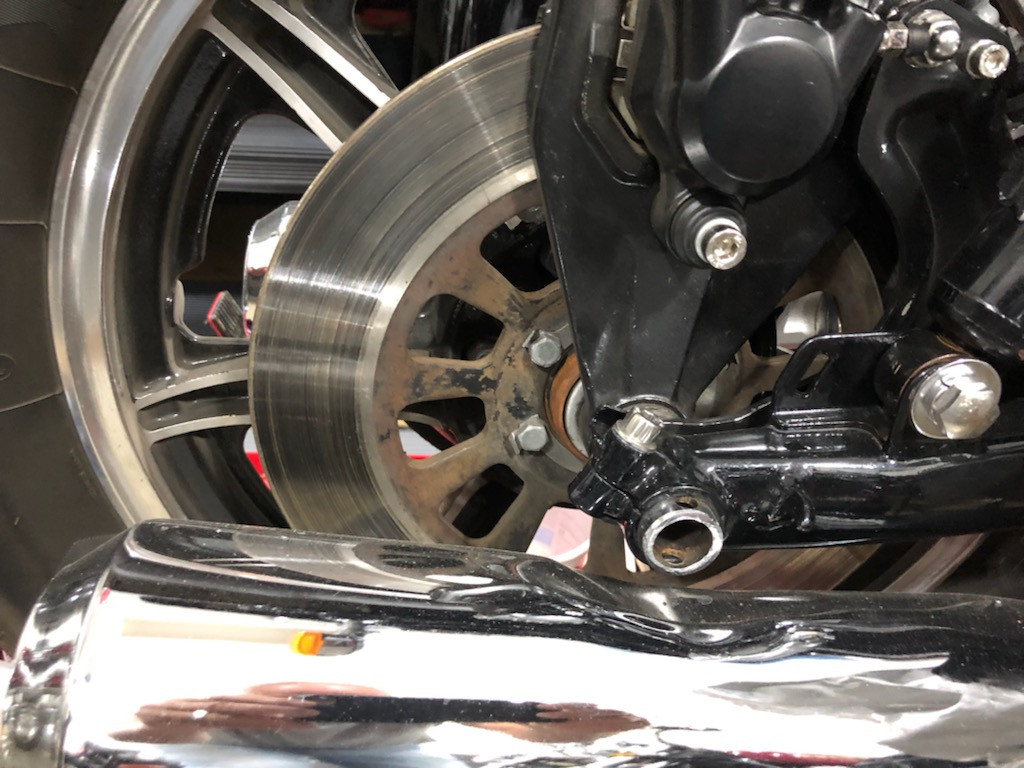

          Rear rotor is slotted, not correct for the Standard and the color as stated is MNS only. 'Sup Greg

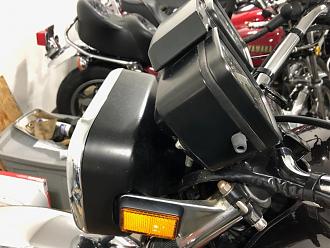

            If you are going for original, in addition to the fender and brake rotors, I think the headlight bucket and gauge covers were originally chrome.
            It will look great whether you keep it as-is, or restore it to the original look.
            • 2manybikes
              • 194
              • Meadows of Dan Va.
              Very nice bike and a great score! The headlight bucket and gauge covers were black. BA80 is correct, the front rotor at least is correct but the center should be black not gold. Be VERY careful of the plastic backs on the mirrors. They will scratch and gouge if you look at them wrong.
              And for any comedians from Michigan, YES that is rust on the center of the rear rotor! Guess the old geezer that put it together missed that detail!
