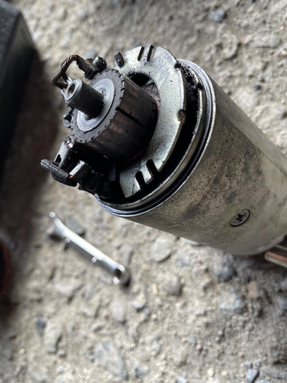

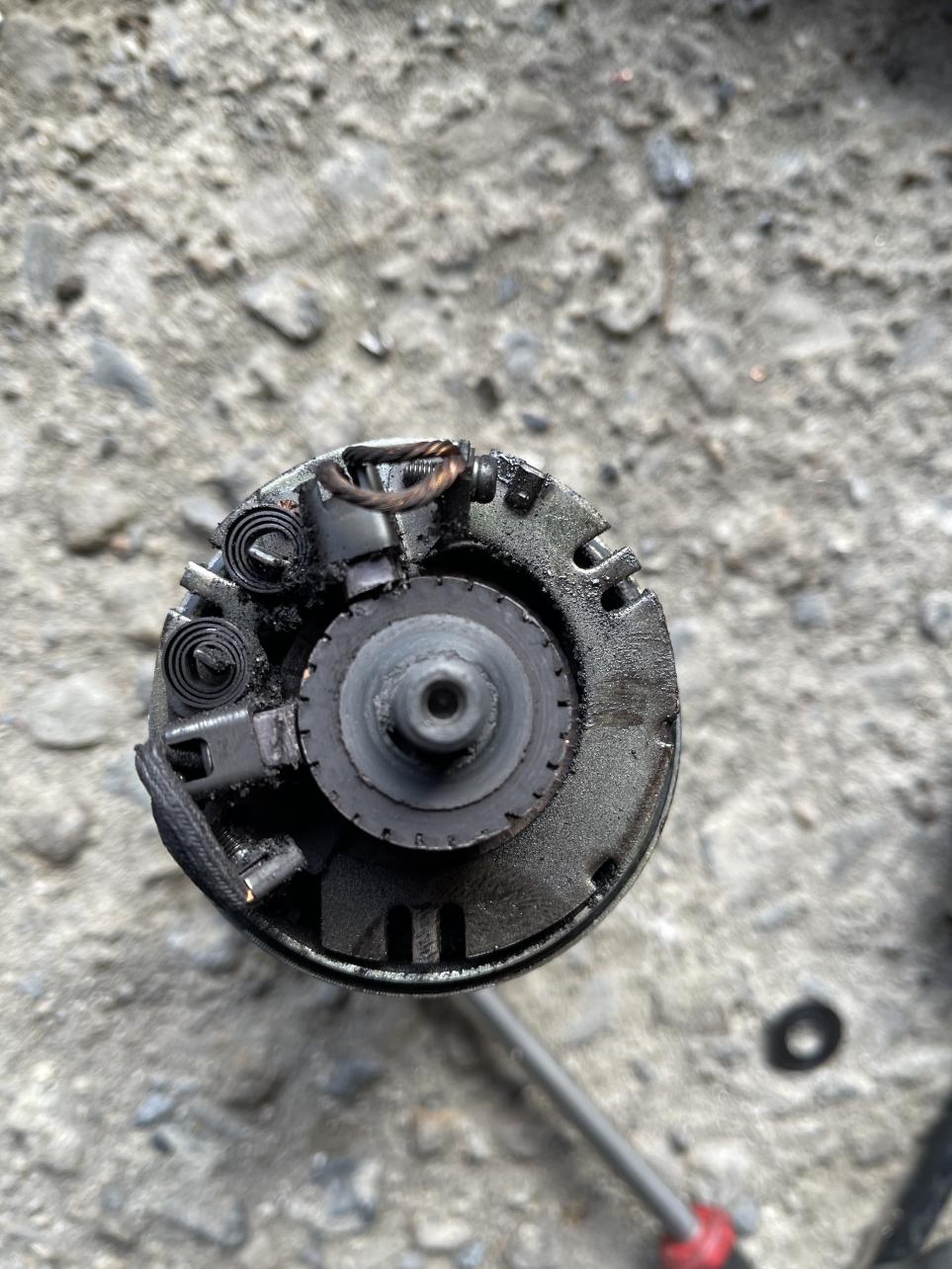

                    Starter doesn’t look / smell so great…

                      • 7598
                      If you can buy the brushes, the rest is easy to fix. Let us know if you need some info on how to do it.
                        • 8629
                        Had a problem like yours not too long ago, slow cranking when cold, slightly better when warm. I had an extra starter on hand, problem solved in 15 minutes. Fast cranking now. There are some on ebay now for about $50.

                            I have 2 starters sitting in a box-I could sell 1 if interested and in NJ so won't take long to get there.
                            Ahhh, damn…I actually bought on on eBay shortly after I posted last, but thank you for the offer!!
                            Thanks for the help (as always!!), guys…now if the weather and random health issues would knock it off for a sec, I can put this thing in!
                            Got mine for a grand total of $40. Not too shabby.
                              I was all about replacing the brushes (to have the experience if anything else), but thought that it would be easier to just get a new one. Next time though, I’m definitely going to rebuild it. Thanks for your help, man…ALWAYS appreciated!!
