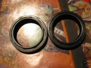

        The seals in most of my forks came from Rusty Riders (a.k.a. eBay seller mssuper).
        They look the same as the OEM, but cost about $12/pair.
        I have been satisfied with them. YMMV

          As I recall the 1979 XS1100SF has a different OE part number than the SG and SH. I don't know what the difference is and the XS1100SF fiche is no longer published. I have a copy, but I don't have access to it right now. Aftermarket seals show the same for all Eleven Specials.
          For aftermarket, I like these from georgefixs Store.
