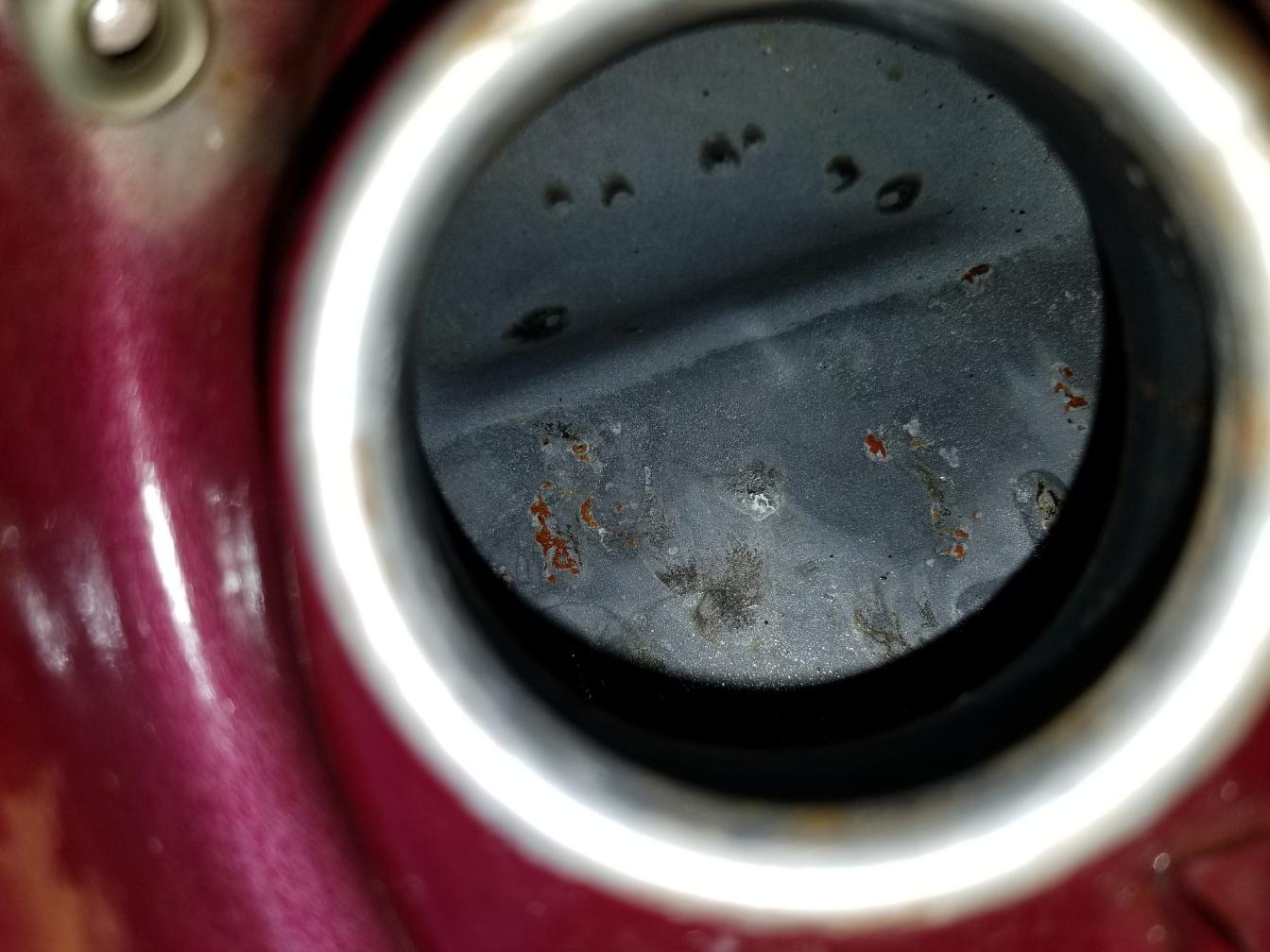

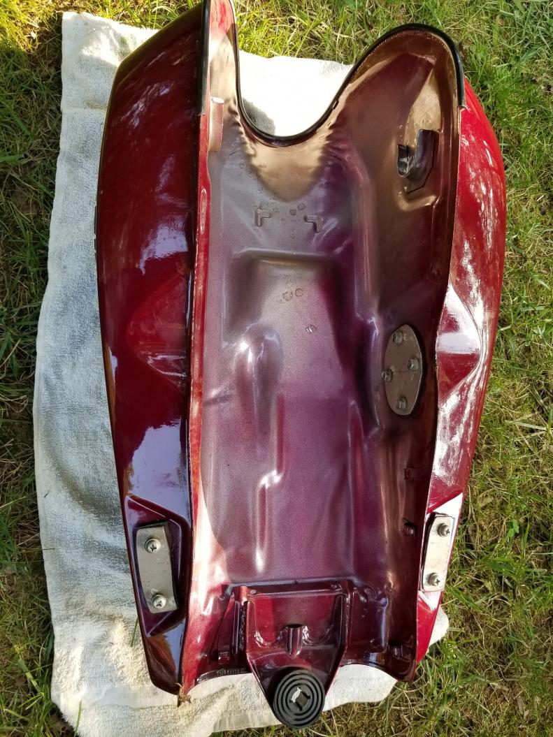

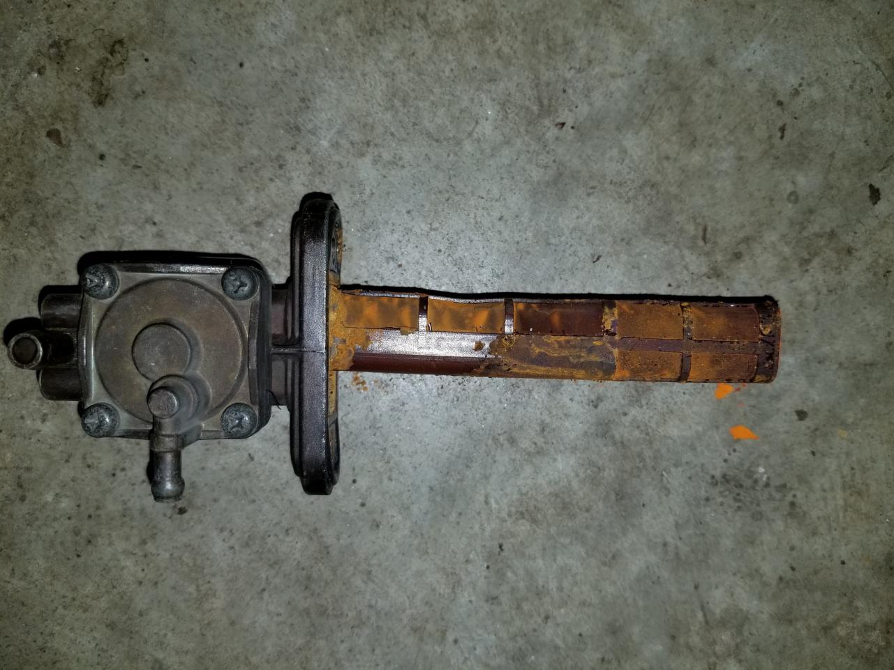

                    That's a good purchase. This cleaning process is not like putting vinegar or apple cider in tank. But if done, inside of tank will be like new. Now just remove the tank and clean it out. Remove fuel gage and petcocks, make up some covers for openings. I use metal and rubber to make up seals. I use fish tank rocks and water to remove heavy rust. Then use Metal Rescue, let sit in tank on all four sides, make sure gas cap has a good seal, over time Metal Rescue will eat away paint. One of my tanks was so bad I had to replace petcock filters and fuel gage. But inside of tank looks like new. No tank sealer to peel away.

                      Pictures of tank clean up.

                        cleaned up well. The apple cider vinegar leaves the tank just as clean and won't hurt petcocks, fuel level electronics or paint.
