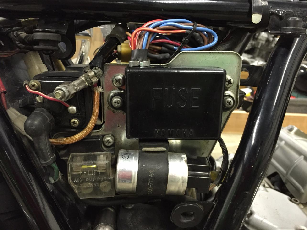

    The bike I purchased is somewhat of a manageable basket case. Previous owner got in over his head so he sold it. Fortunately he threw away a lot of parts. Just bought a battery box. All my electronics are there, I just don't know where to hang them on the box. Could someone share a few pictures or a diagram showing me where they go on the box.

    Not sure if you have a Standard or Special model. Perhaps it doesn't matter for your question.
    The battery is removed from the left side of the battery box, so nothing is mounted on the left side.
    The right side of a Special looks like this:
Name:	Fuse Box - Covered.JPG
    On the Special model, the Ignition Control Module is mounted on top of the rear fender.
    Hope it helps!

      That is exactly what I needed thanks
