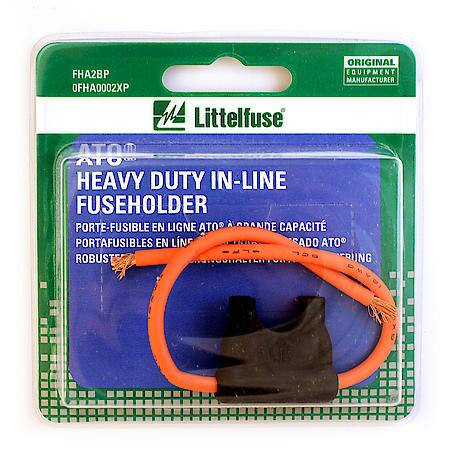

    I would cut the wires off close to the fuse panel and install an inline fuse holder with butt connectors. Any auto parts store will have them. Looks like you have one on there already. Click image for larger version  Name:	fuse holder.jpg Views:	0 Size:	76.0 KB ID:	866933
      I wondered if thats how that one newer style connector got there...thanks ill do that. Didn't even think just posted here lol. Got 8 of my bikes ready for winter storage here in my garage today so doing 100 different things

        If you already have the new blade type box and fuses then just go ahead and do the swap. Why buy something you will soon not need? It is not that big of a job and doesn't really take that long to swap it out.

          Saving for another potential build and this bike is being sold. If the new owner wants the conversion pieces i will certainly throw them in. I have 8 soon to be 9 motorcycles....lots of projects between now and spring....don't need another one!
