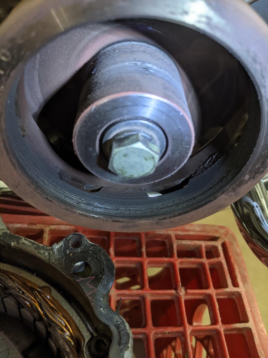

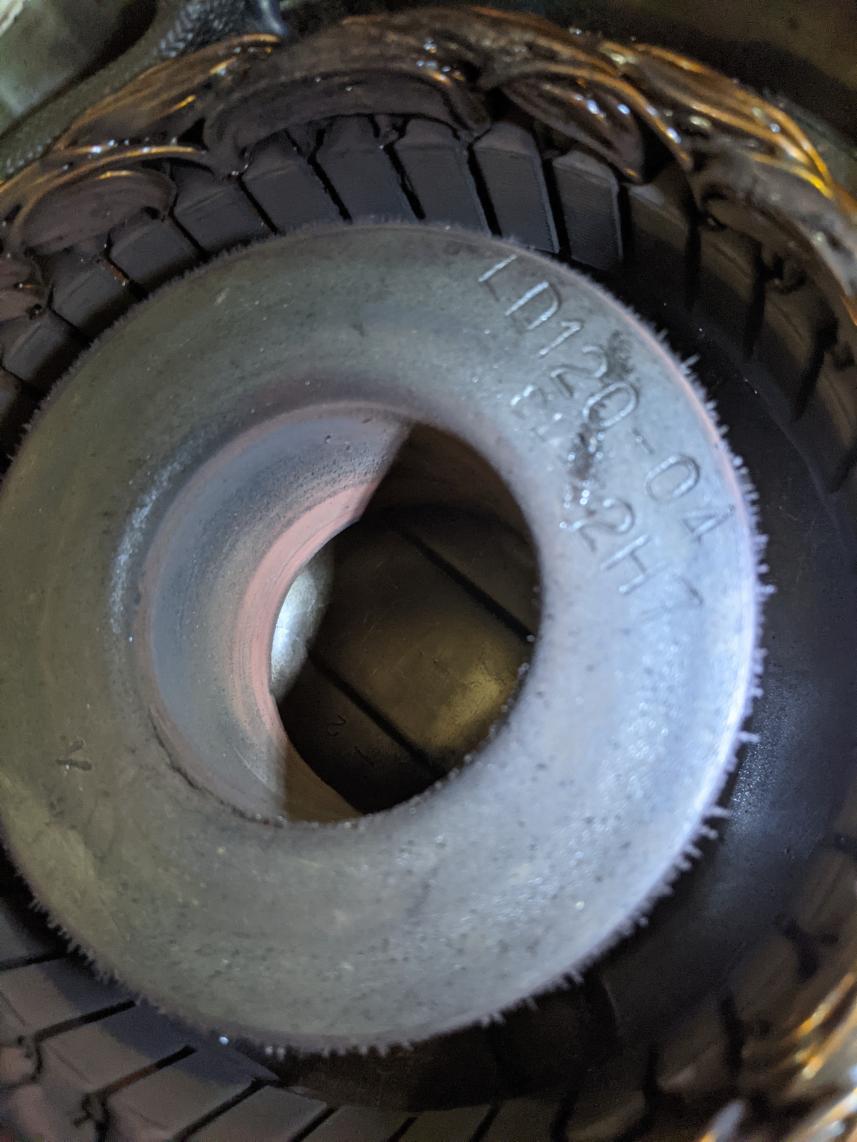

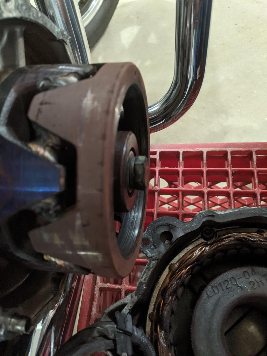

        Took it apart, inspected, cleaned and re-assembled sounds great now. I saw some rub marks so when I put it back together I seated it, hand tightened the 3 bolts then lightly tapped on it with small dead blow hammer to make sure it was seated (in case it got buggered) then evenly tightened it down.
