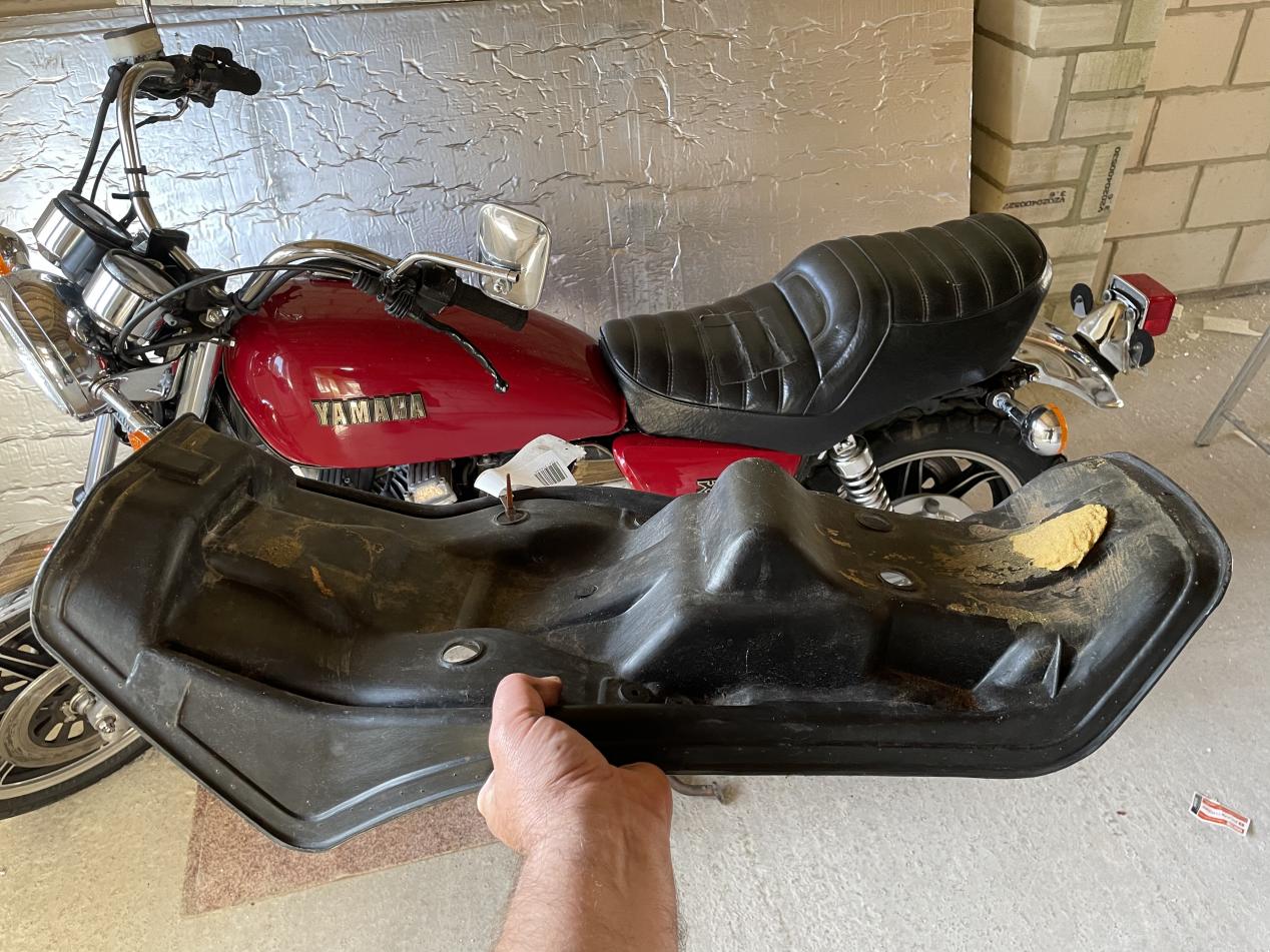

ID:	866293 My newly acquired SF has just turned up and I'm straight into it. Love this bike!
    I could see from the pictures in the ad that it had the wrong seat on. The same people selling the bike were also separately selling what they said was an SF seat base. So I bought that too and they were delivered together. Now looking at the seat base and scratching my head. I don't know what it is but I am pretty sure I know what it isn't. An SF seat base. Unless I'm being thick. Which is always possible!

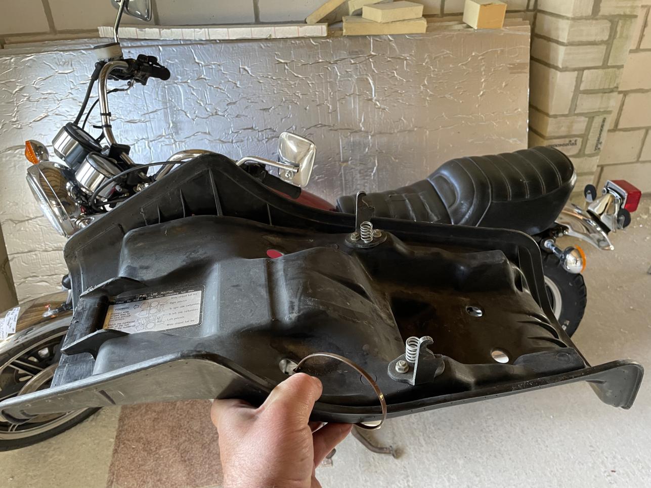

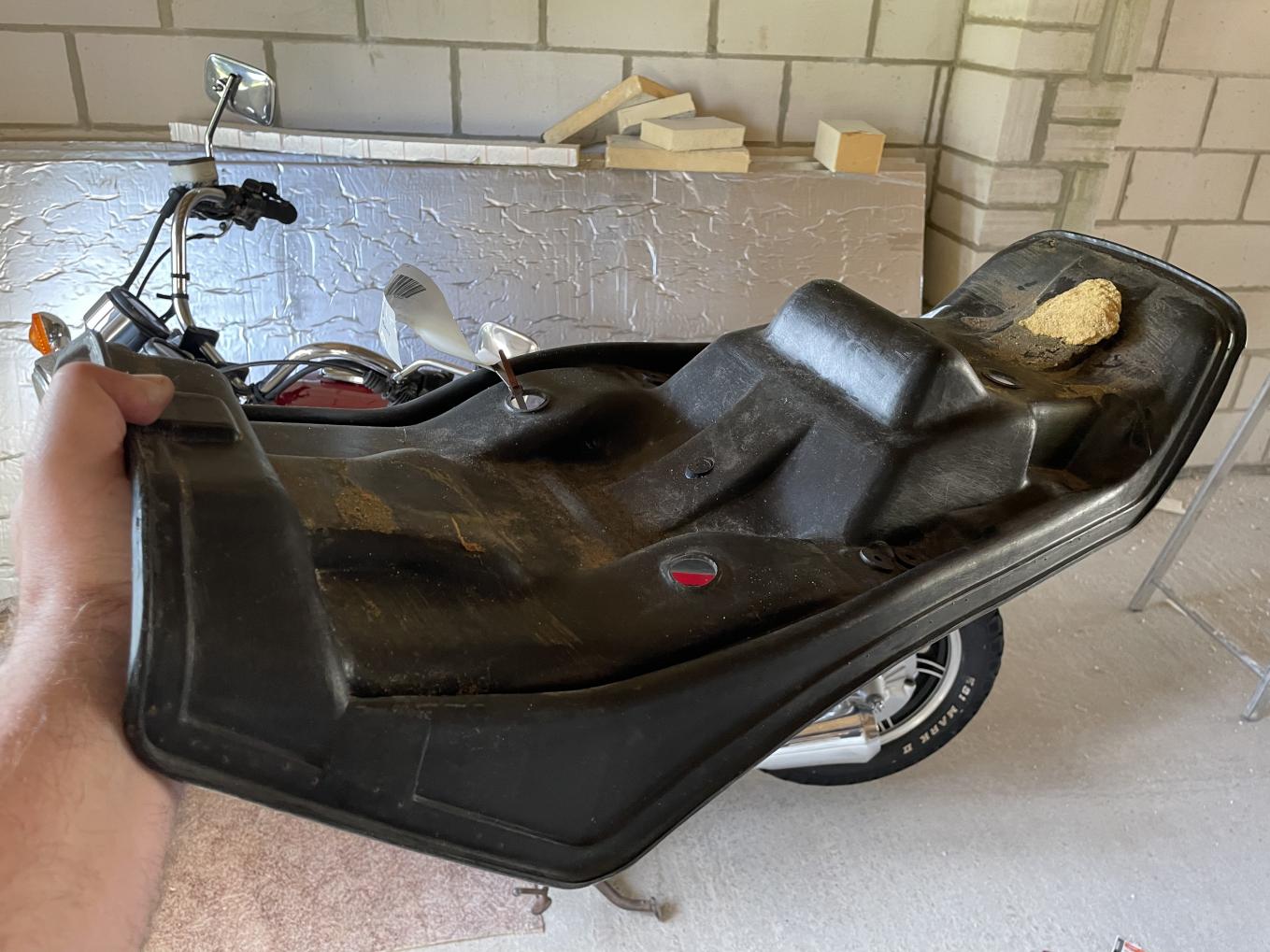

    Pictures attached of seat on the bike and separate seat base. Can anybody identify this for me please? If it is the wrong base it's going back where it came from because it was expensive!

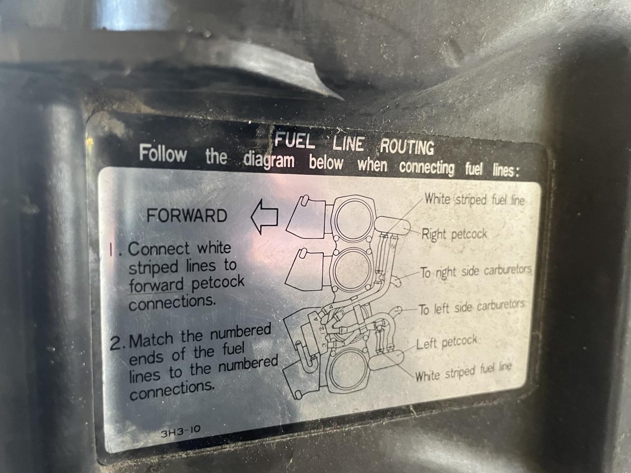

    The seat base will not fit ANY XS1100! It looks like an XJ seat of some type. The 3H3 is a clue, but that label could have been installed by someone else. The rear of the '79 seat has metal that wraps around the back, to hide the mounts, etc. All the later seats have an "open" back, like those in your photos.
    This is a "modified" 1980 Special seat pan. Note the steel around the rear of the seat, and if you can see it, the cut sides so it will not lay on the side cover.
