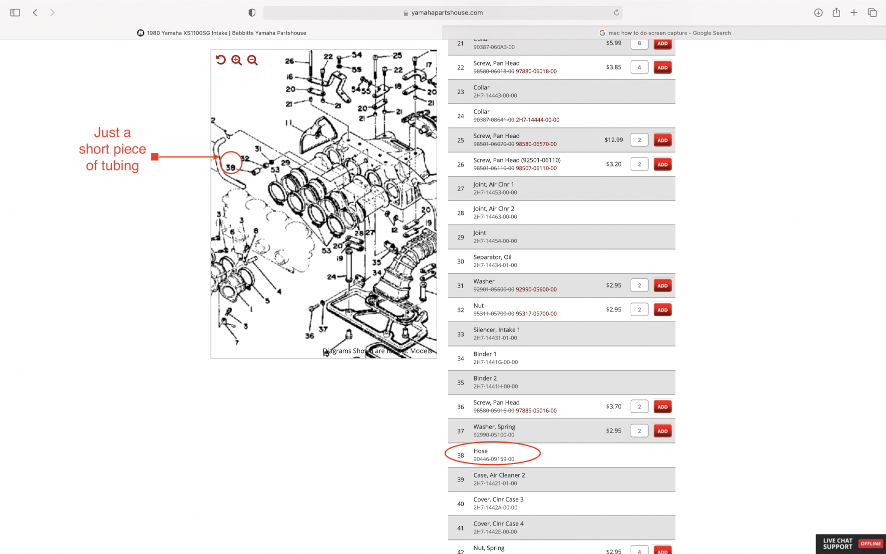

              Its just a piece of tubing put over the threads and nut head for the distribution manifold mount.

                  My SG still had both the originals on it. I think Yamaha did that to keep the fuel lines from contacting the metal threads so any wear point would be avoided.

Name:	Screen Shot 2021-08-08 at 9.41.06 AM.png
