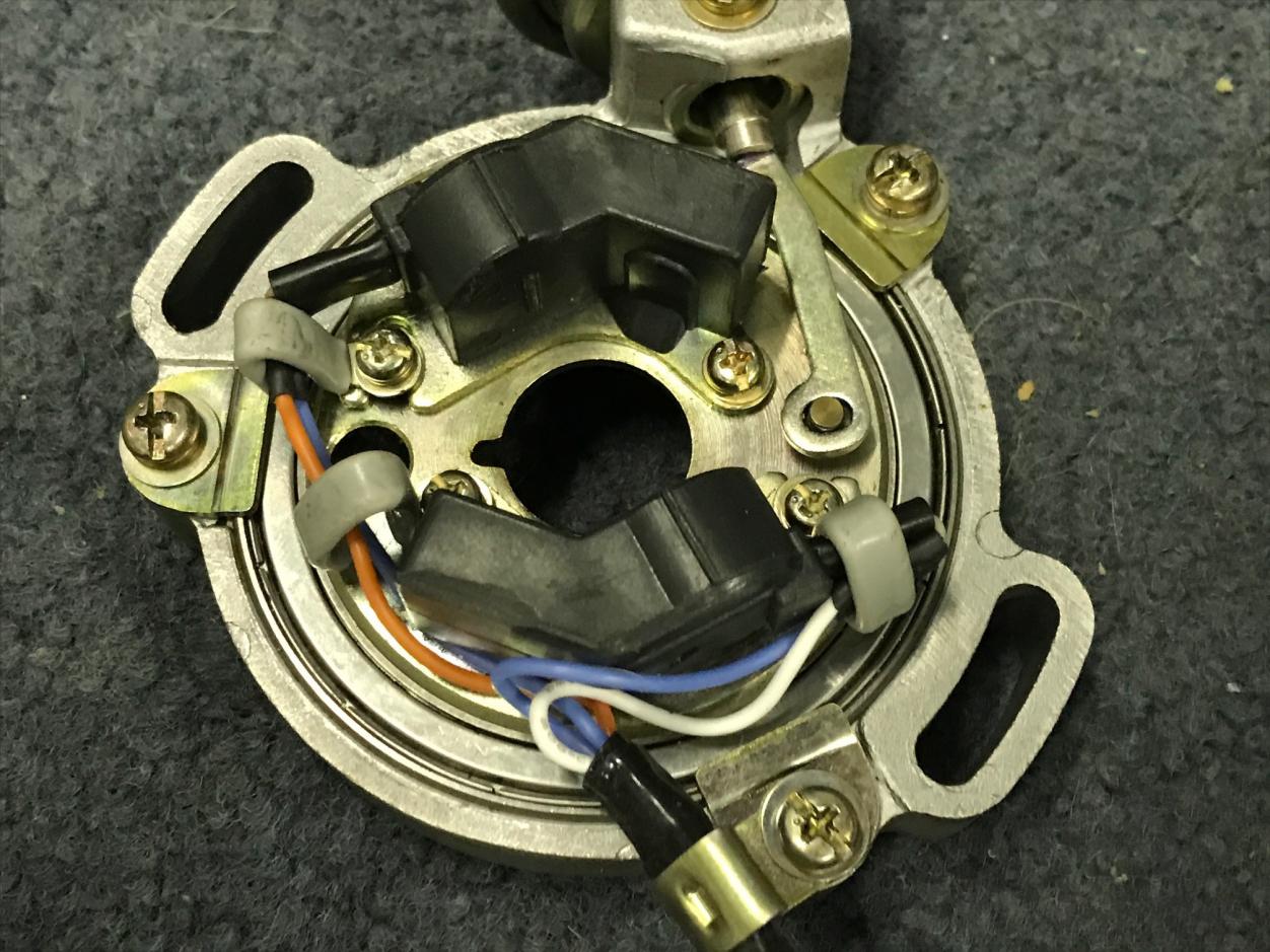

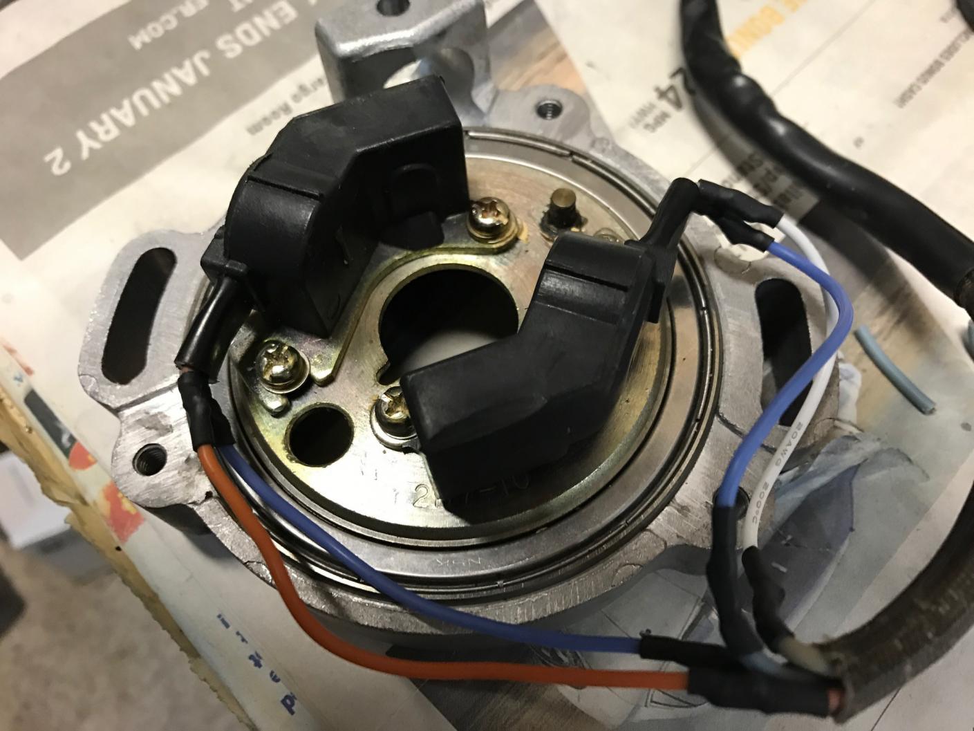

                        Has anyone located a source to buy some of this type of silicone sheathed flexible wire? I would hate to cannibalize a good set of test leads for that. I just had to do another repair.

Name:	Pickup Coil Splices.JPG
Name:	PIckup Wires Dressed.jpg

                            I just did this repair on my 78. Would stumble slightly just off idle when the motor was hot and the outside temp was 93°. I ran the bike at idle with the left cover off and used a small dental hook to pull on individual wires. The second I touched a wire, the bike shut off. I repaired the wire with voltmeter lead wire and small segments of shrink wrap with internal adhesive. I also modified those pinch points so the are not so rough on the wires. About 800 miles so far with no issues.
