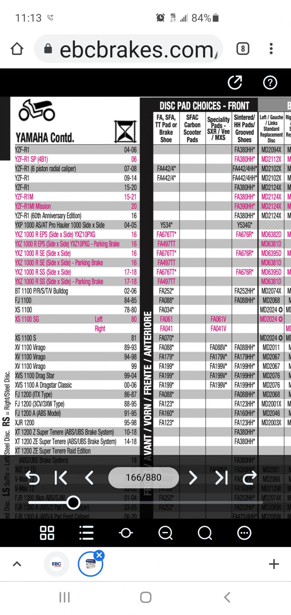

    Going to order master cylinder rebuild kit new brake pads fluid et cetera. Always had good luck with EBC organic on my older bikes. Very confusing to find the right brake pad front and rear for this bike based on year and being a special. Went to EBC manual catalog and looked through and it looks like there's a different brake pad number for left and right on the front. Can anybody verify this? Very confusing. The worst thing is it has 1980 next to it so I'm not sure if that was different than 1979 see attached pic.
    Yes, the pads ARE different! The front has a different set for the left and right because of the design of the brakes. The rear is the same as all the rest of the XS1100 rear pads, so it's easy. That list does NOT list the '79SF, but I think it's the same as the SG. I would make SURE before ordering the pads.I bought the set I use from ebay a while ago, so I don't remember who I got them from, sorry.
    Look at the old master BEFORE you order a kit. I had to replace the one on my '79 Special because it had a bad pit in the bottom of the bore from water.
      The chart is too fuzzy for me to read.
      I can tell you the front left and front right pads for the Specials are different from each other. They have a slanted shape to the pads so the pads are not a homogenous thickness. The angle of the slant is opposite for each side.
      However, the pads are the same for all years of the Special.

        OK... So still confusing...
        Left caliper has different OR same pads on right and left placement?
        Right caliper has different or same pads on right and left placement?
        Left caliper uses two pads that ARE identical and those are different from the right caliper that uses two pads that ARE also identical?????? +

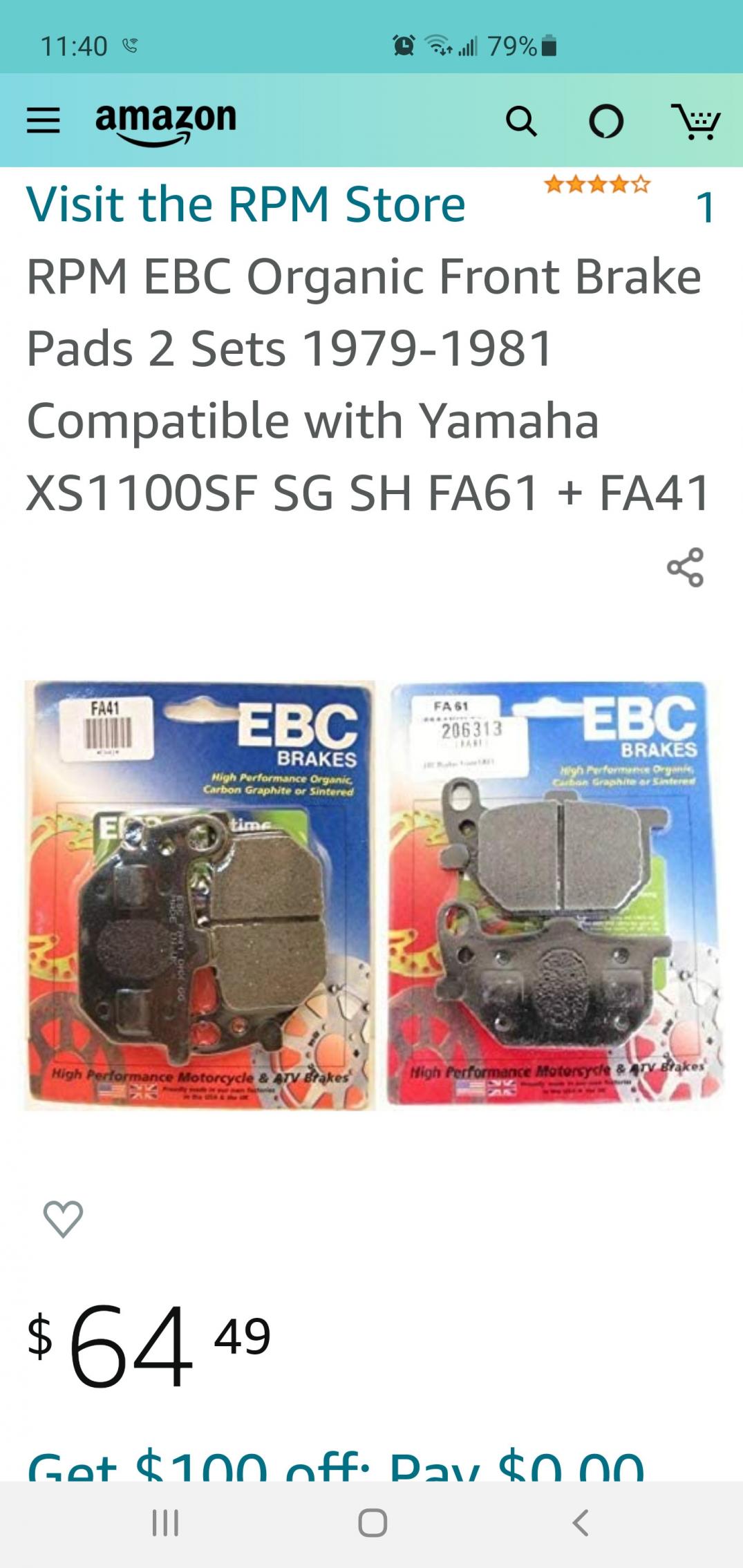

        Pic of Amazon order.... Looks like a 61 and a 41 both for front

          EBC #'s
          Front:
          Left side is FA-61
          Right side is FA-41
          Rear is FA-34
          This applies to all Specials except '81 Midnight Specials

                    I knew there were left and right front pad sets but I could only find EBC’s FA61 part number, thanks for the post showing the right side part number FA41.
