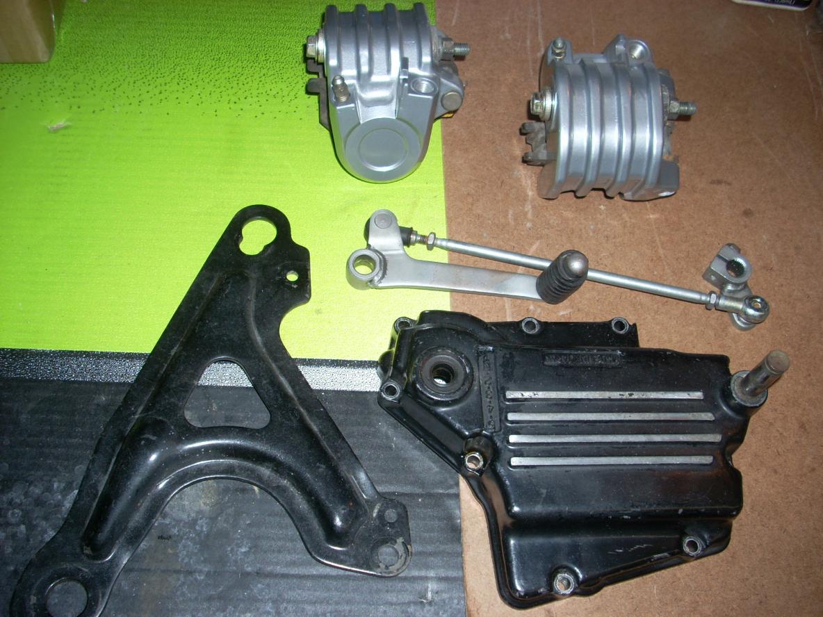

      The standard and special triple trees are different to compensate the different forks axel location.

        Bike is looking nice! The shifter is aftermarket "forward control", not stock. You will need to remove the bolts on the airbox to install the carbs. If you have not replaced or treated the rubber parts, I'll get the name of the product I use. It's about $20 for a small windex size squirt bottle, but works very well.
          • 8870
          Yes, triple trees are different for Standard and Special. The Special forks have a leading front axle, Standard does not. They use different TT's to keep the geometry exactly the same for the two models.
          Ok, I see it has been answered already.
            Thanx Red Bandit
            That is what I was wondering in my original post, I only checked the trees for width between the bores, I will have to scrutinize them more carefully to see if any have a different angle. Is there an easy way to spot the difference? Casting marks? Or maybe a part number? Doh! I will dig out what I have and get some images to post up.

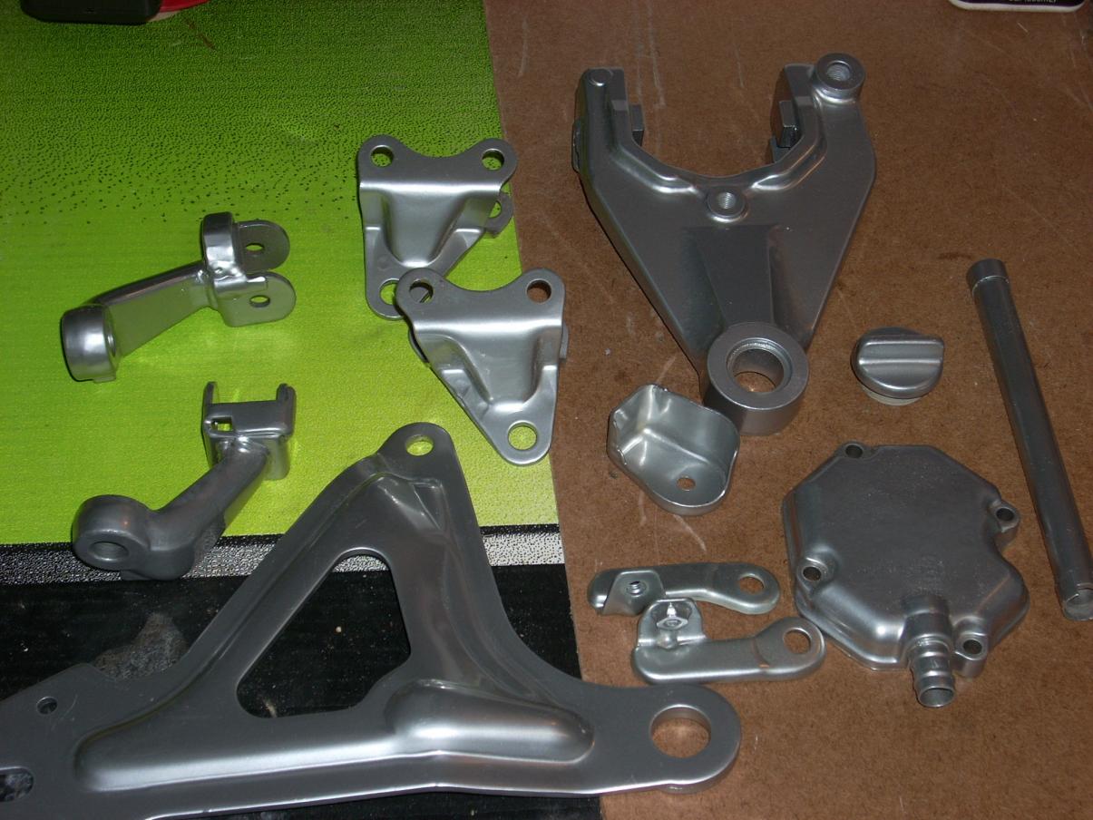

              Thanx DiverRay
              I had access to some nice shop facilities during the early part of this project. I don't currently have access to the powder coating equipment I used, sure do miss that. I am working with some friends to build an oven and spray booth for our local Hacker Space.
              I found the shifter cover on Ebay early on, I also have the foot pegs that shift your feet rearward for proper foot geometry. LOL
              I just stuck the airbox up there for a little color, and mock-up. I have all new rubber bits for the induction end, I would be interested in the rubber restore product to maintain the bits I have. I will remove the airbox during engine install.

                  • 8870
                  OK. The shifter and cover are from a 2H9 XS11 European setup, they are factory Yamaha parts though. With that setup, different footpegs were also used. I believe the ones in your pic are US type. Foot location may be off a bit.

                                • 8870
                                Originally posted by XS-play
                                I scored the footpegs, too. Total dumb luck, separate purchases on Ebay. In 2013 there were tons of cheap parts on Ebay.
                                The foot brake lever is shorter too.
