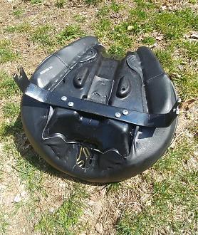

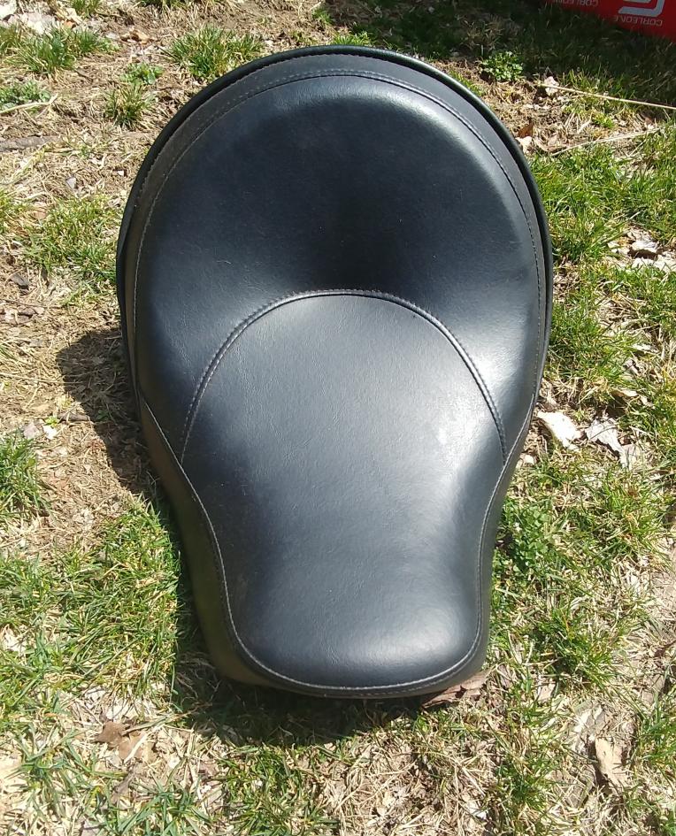

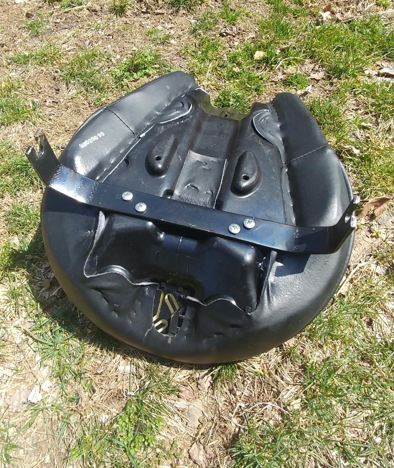

                Hello Sky. I mounted a solo seat on my military theme xs1100... Pictured is the mounting bracket that I made out of steel flat bar with slots that mounts to the the top shock bolts that go through the frame. the slots allow you to adjust the seat height, up or down as needed. However my shocks and fender are stock but if you only need 1/2 inch, something like this might work for you. Good luck with your project.

                  Hey Ranger, sweet simple and effective seat modification. I like it! I want to see the rest of this bike. Sounds neat to have a military themed XS
