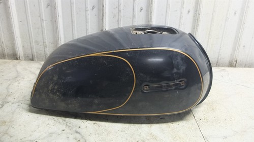

                      - I'ma need a tank.

                            Tank. Needs work.
                            https://www.ebay.com/itm/27634669509...Bk9SR_KDqO3GYw
