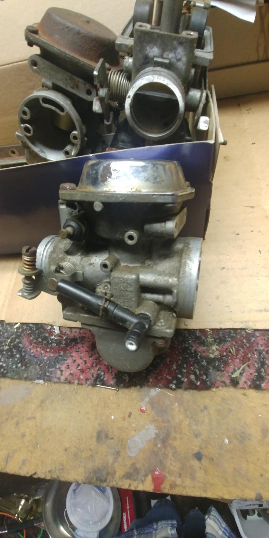

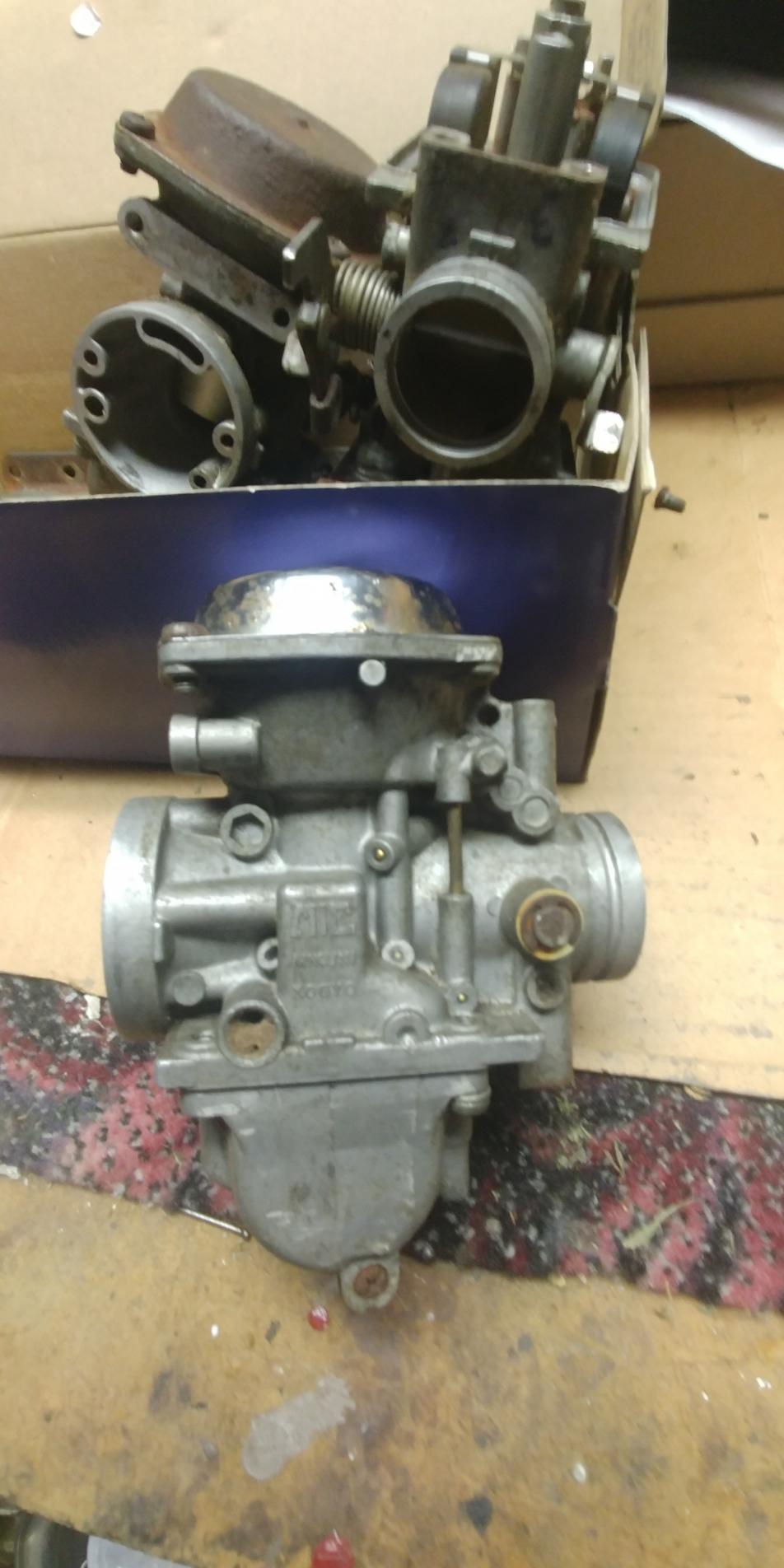

                    Cajun, I checked in my box of misc carbs and found that I don't have a #1 but I do have a #4 that I believe is off of a special. (If the upload works, it's the bottom carb in the picture, ) ... the slide and the butterfly moves freely and the main jet turned freely. and the body appears to be in good shape, however the other jets may be stuck. I made a weak attempt to unscrew the pilot jet and felt the screwdriver start to slip and the jet didn't budge, the mixture screw also didn't budge. so there will be some work required there. If interested, PM me when you get a chance. Bob

                      I messaged you on the carb. By the way I have followed your bike projects on wordpress. Very nice work and the bikes turned out amazing. Keep it up ... restoring these bikes is a great hobby. Of course I am biased and love the original. Some of the cafes are interesting but I am way too old to give up comfort for style.
                        Got it Cajun, I'll get that carb out to you by the end of the week.
