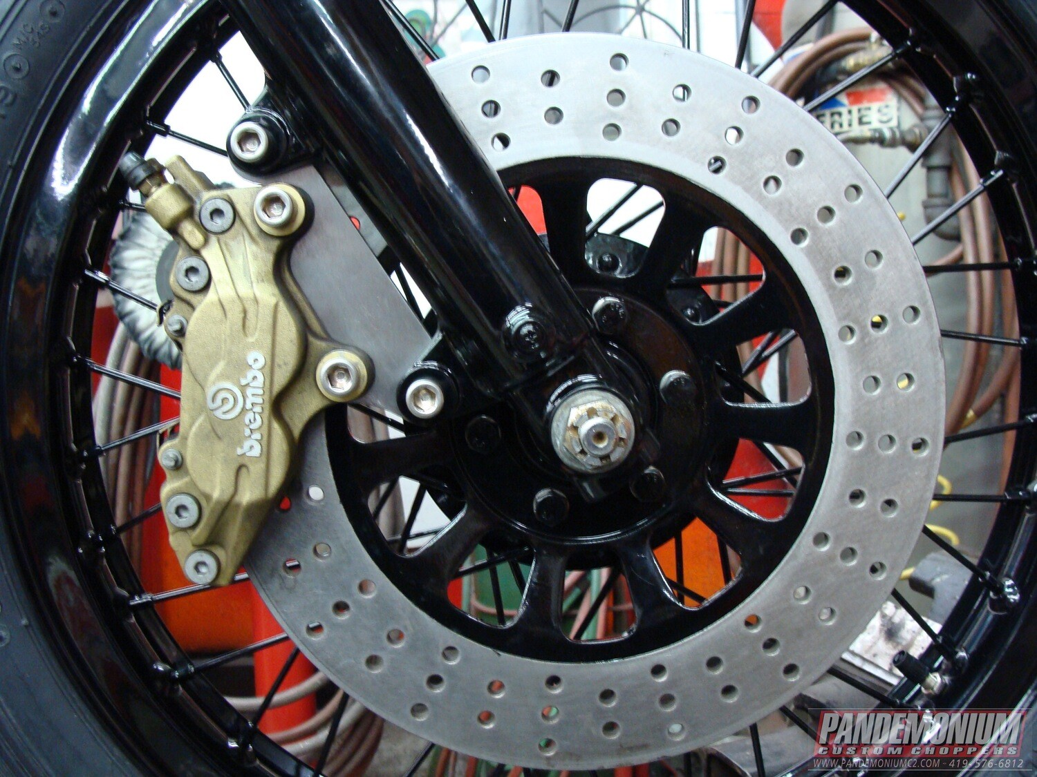

    With Roxy running again, its time to begin my next project to screw her up once more. Id like to replace my brake calipers with newer calipers. The old ones have seen their share of miles and are ready for retirement. Is there a good set of front and rear calipers that are a direct drop in replacement? If not, what would I have to make or modify to make a good set fit?
    1979 XS1100F "Roxy" (my first bike ) - '91 Suzuki GSX1100 Fairing, BMW bags, Cheap ABS Trunk, aftermarket cruiser seat, MAC 4-2 exhaust, Heavy Duty folding kickstart, XS11 Special signals and gauges, Blade Fuse Conversion, Dynacoil Greens w/ ballast bypass, SS brake lines
    If your XS11 is a standard, it's fairly easy. There are kits available to adapt Brembo calipers. Pandemonium has a kit that I believe goes to the 65 mm caliper.
    Motolanna has a kit for the 40 mm caliper. If you look, I think you'll find they have both sides. The bike fitment you're looking for is XS650 with 35 mm forks.
    I'll you're doing this, you'll want lighter rotors. XJ4ever.com is a good source. Or 650Central.com will hook you up.
