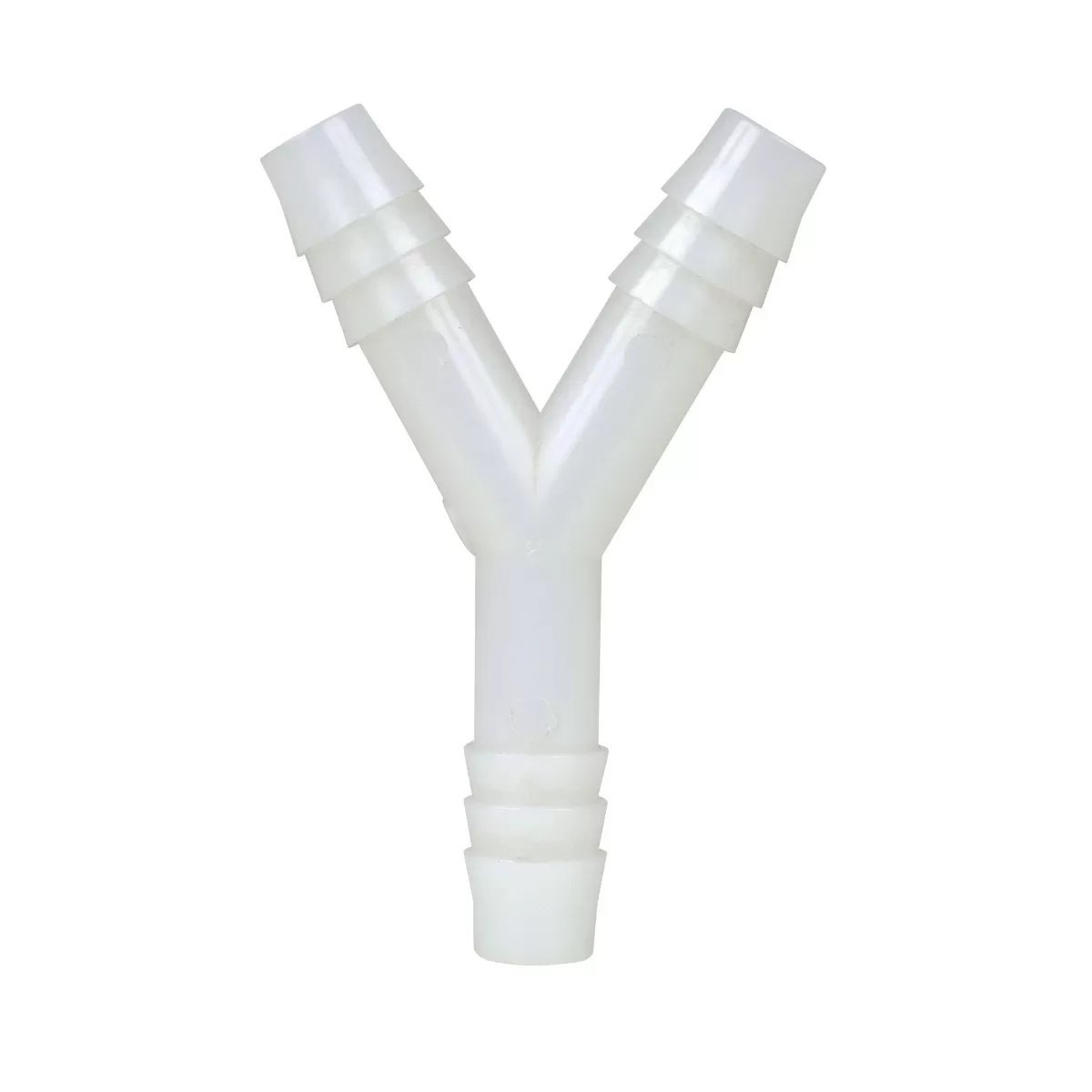

    First off, I don't know where the heck y'all found a Y fitting for a 1/4" fuel line, but they DO NOT exist at any of the SEVEN different auto parts stores and one hardware store I went to locally. I did find a couple of T's, but no Y's. Even finding them online has proved nigh-impossible. I did find some Y fittings meant for vacuum applications, but the ones I found either didn't say the material, or were marked PVC plastic, which is not good to mix with gasoline, as I understand.
    This is the closest I could find online.
    I really wanted to ride last weekend, and these would take a while to ship, so I proceeded without the Y's.

    - Any other recommendations for a Y fuel line than this? https://www.qcsupply.com/130205-barb...tings-1-4.html
