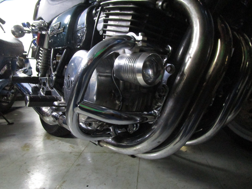

      Aux Lamps $20
      I recommend these:
      LED and minimal draw. A little bit of wiring to get them all set-up but fantastic for a measly $20.
      I have them on all my XS11's and will soon mount them on the FJ1200. I refer to these as SEE ME LIGHTS and I never drive without them on! They also can be switched to FLICKER bu quickly turning then off/on.
      Also..... provide a hell of a lot of extra light for night riding the ole' XS11 lamps just ain't up to the modern tech.
      Additionally, all the front turns on my XS11's have been converted to dual filament 1157's. They are on always (one filament) like modern bikes..... One more way to BE SEEN!!

        Where do you get those Kurt?
        1980 XS1100SG
        1998 KLR 650
          • 1262
          Evil-Bay
          https://www.ebay.com/itm/CREE-U2-30W...53.m1438.l2649
          This is not the same seller I purchased mine from but these are the lamps. They are now less than $17 a pair.
          CREE U2 30w ARE the units mounted on my bikes.....
          You will have to do a little wiring. I power mine using the accessory fuse unit or on the bikes with the new modern fuse assembly installed I used the extra fuse spots. It WILL take a little work (a couple hours) to do a NICE job but WELL WORTH THE EFFORT.
          1982 - CBX1000 - Honda
