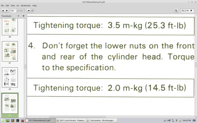

            If you have a 1/2" torque wrench, and preferably 6 point socket(s), you can check the head bolt torques with little effort and no risk. The biggest effort is removing the gas tank to get to all the bolts.
            The procedure is super fast and easy. You start with the bolts in the middle and work outward.
            I would not loosen the bolts before tightening them. I think that is asking for trouble.

                Nice chart. Thank you. First the tank, I am comfortable removing it. The auto-parts store loans a 1/2 in dr ft lb torque wrench. I may do this. Are they all 14 mm?

                            Well, I got a torque wrench today. They were not loose- the wrench clicked right away. I did not loosen first. The last 2 are 12 mm instead of 14 mm socket won't fit so I tightened a little with a wrench.
                            It might be seeping down from the cam cover or the chain tensioner.
                            I learned some stuff and didn't break anything.
