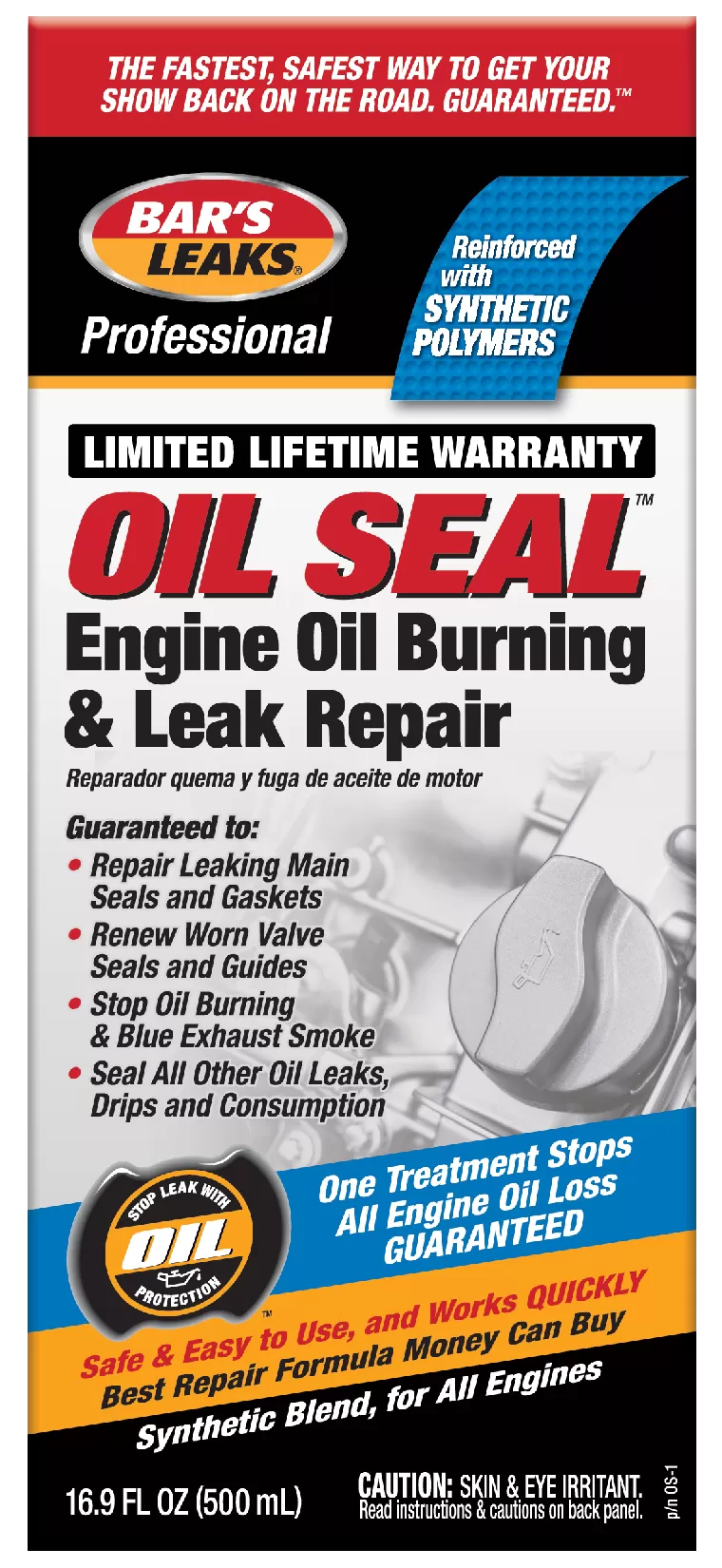

        To save you some teardown time/$$ this year, they also make a rubber seal conditioner that can be added to the OIL to help re-soften rubber seals like the valve seals to possibly help them seal better, for a while at least.
        I don't know exactly what's in the conditioner and whether it can affect the wet clutches??
        PS, did some research, found 3 of the newest formulations/brands:
        Lucas Oil stop leak, Blue Devil, and Bars Leaks stop leak.
        Found this info on FAQ for Bars Leaks:
        Will Bar’s Leaks Oil Seal Engine Oil Burning & Leak Repair work in my engine?
        Yes, your vehicle is a good candidate for this solution if it does not consume more than one quart of oil per day. We have designed this product to work in all gasoline and diesel engines including turbocharged, EcoBoost, hybrid and even racing engines. This covers 3, 4, 5, 6, 8 and 10 cylinder engines in all cars, trucks, vans and SUV’s, also can be used in heavy-duty applications referencing the appropriate dosage level. This applies to a wide range of other motor applications too: tractors, boats, RV’s, motorcycles (including wet clutch), ATV’s, lawn equipment.
        Here's the webpage link:
        Here's a webpage with background info on Previous formulations that were NOT good for the engine/seals, along with explanation of latest formulations.
        In This Guide What is a Stop Leak Additive? First Formula Improvements to the Formula Top 3 Oil Stop Leak Additives Do Stop Leak Products Work? What is a Stop Leak Additive? An stop leak additive is a non-solvent chemical formula containing a blend of friction modifiers and other refined…

            Thanks T.C. that's a good idea. I bookmarked it to look into before I put fresh oil in.
