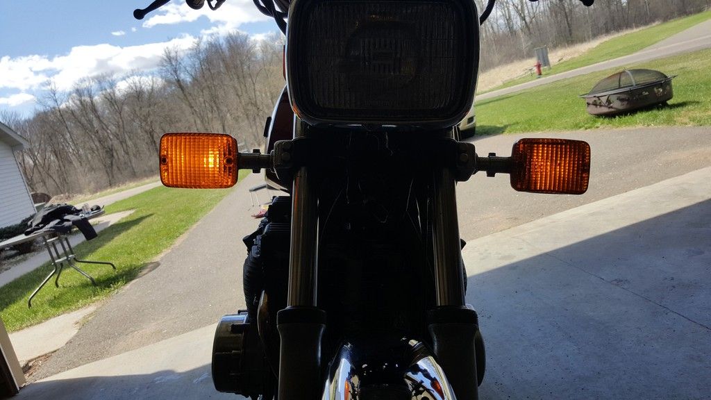

    With and without the factory headlight

      Can't edit my posts for some reason or I would have added this to my previous posts.
      And one mid swap. Right side signal is the led with reflective tape, left side signal is incandescent with reflective tape.
      I chose the yellow reflective tape knowing that leds transmit a very specific light spectrum. Yellow led, reflecting against standard reflector as well as yellow reflective tape, and thru the yellow lens cover. A cheap and easy way to increase signal visibility.

        It looks pretty good, nice contrast between the LED and incandescent lamps!
