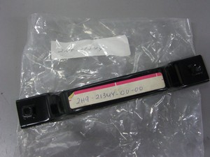

      That makes a bit more sense with the horn. I had a metal piece I couldn't figure out what it was for. It looks like this:
      Is this the piece that mounts to the frame, and then the horn to it?

        Yes, that looks like the horn mount. One horn should be on each side of the tank, just in front and below. The part number tag is probably hiding the mount holes. IIRC the weld nuts go to the back of the bike, but I'm not 100% sure.
