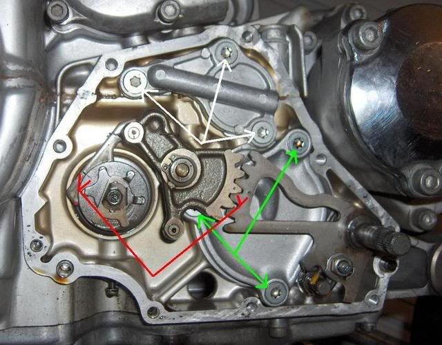

                          Hey Fields, and Tod,
                          Okay, will refer to this photo already posted.
                          Now, look at the part that the shift lever fits onto, there's a spring and bolt/nut just below down there, that's where you can make the adjustment to position the shift pawl so that the drum and pawl marks can be re-aligned.
                          Scott/3Phase and I talked a good while back about a way to MOD the shift drum star plate since it's no longer available. We couldn't come up with a good technical reason why Yamaha made it that way with different length pins when the stress on them within the drum slot is the same since the slot is the same width, and the pins are the same diameter. SO...I theorized about getting a thick piece of steel plate, just cutting it into a washer/circle, will take some precise work to make the center mounting hole along with the other 2 alignment holes for that special V shaped outer washer. Then just use a grinder to grind the pins flush with the drum where they stick out, and then mount the modded washer onto the end of the drum.
                          Since you/Fields were able to find a spare unbent washer, then this is moot, but just wanted to throw that out there again.

                            The new washer and pins seems to have done the job. Shifts much nicer now.
                            TC- that's interesting what you say about the mod idea. I can't see why it wouldn't work. It's a very strange way of designing a retainer. Perhaps Yamaha designed the ears in the star washer in that way so they would withstand more force ? The shape of the ears would distribute the force differently and change the way pressure is applied on the washer from the pin.
                            How does that adjustment work? Do I just loosen the nut and rotate the actuator until it lines up?
                            1982 XS1100RH
                            1982 KLX250B
                              Yes, loosen the nut, turn the adjustment screw until proper alignment, tighten down the nut.
