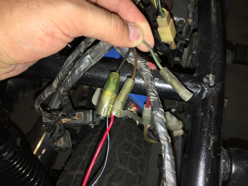

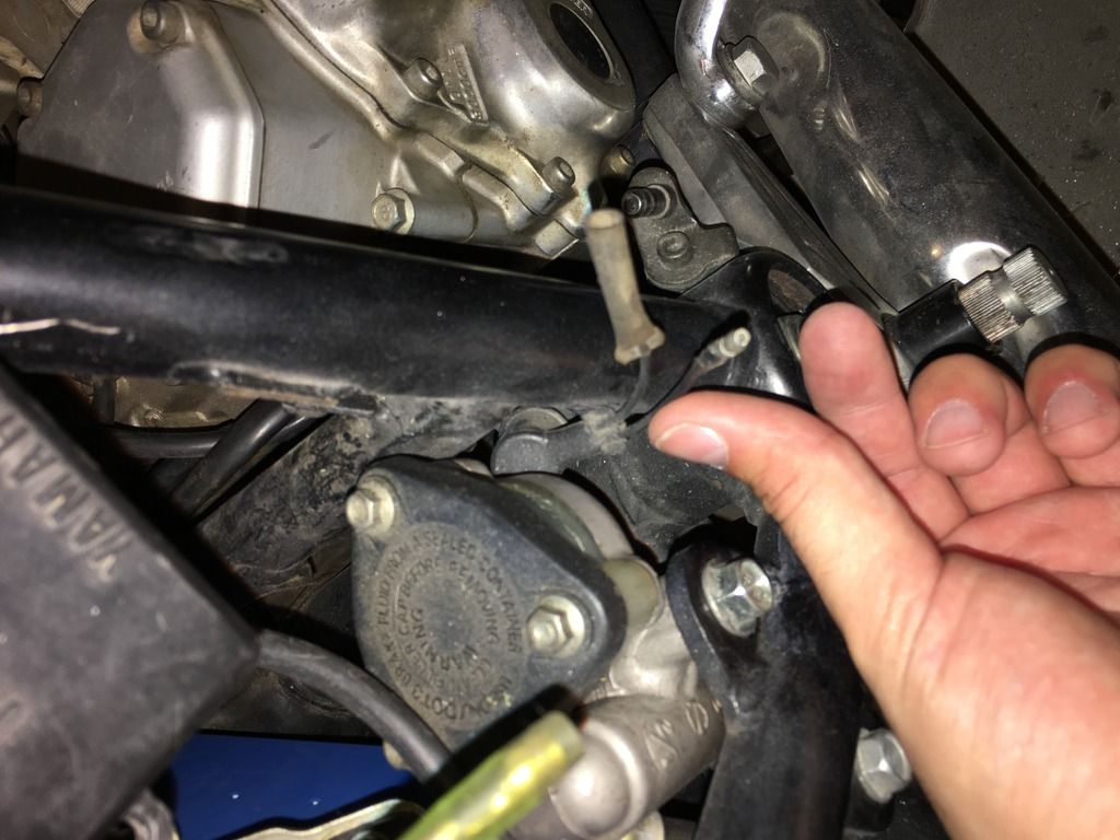

I did, thank you. Also, I have that original service manual and the clymer manual. They are helpful but I just can't see exactly what is supposed to go where as far as a couple wires go. I will take some pictures and pose them tomorrow. One is the black male end wire coming from the starter on the back of the engine, the red/black oil pressure switch wire, I have no clue where the oil pressure switch is and what wires hook up to the two rear brake switch. Like I said, I will post pics tomorrow. This is my first build so I'm short on experience, very eager to learn81 SHComment

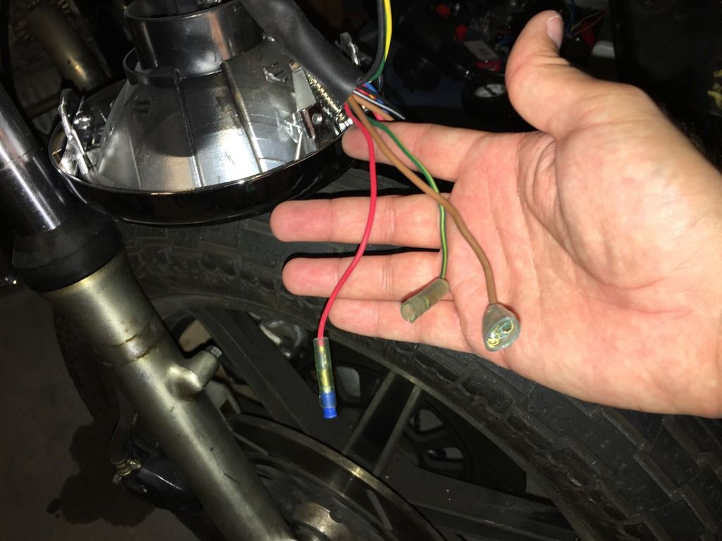

these are hanging out of the front

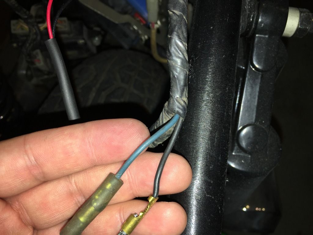

these are in the back of the bike
http://s1174.photobucket.com/user/co...tml?sort=3&o=3
http://s1174.photobucket.com/user/co...tml?sort=3&o=4
any help or pictures of connected wiring any of you could offer would be greatly appreciated!81 SHComment
The green and yellow are from the front brake switch and there is a mate for it in the harness.wingnut

Okay, for the rear brake switch, the brown and the green/yellow on the harness side look like they go there according the wiring diagram. Note one is male, one female, both on the rear switch wires as well as the harness wires, only goes one way.
The Front wires....the solid red I think is a direct 12V+ hot unswitched wire for an accessory of your choice....test it with a voltmeter with the key off to see for sure. The big brown is a SWITCHED 12V+ source, again for an accessory if desired.
The rear harness, Blue is running lights/tail lights, and the black is probably ground, again test with voltmeter.
The other 3 wires on the rear, black, green, brown look like the ground and left/right turn signals wires.

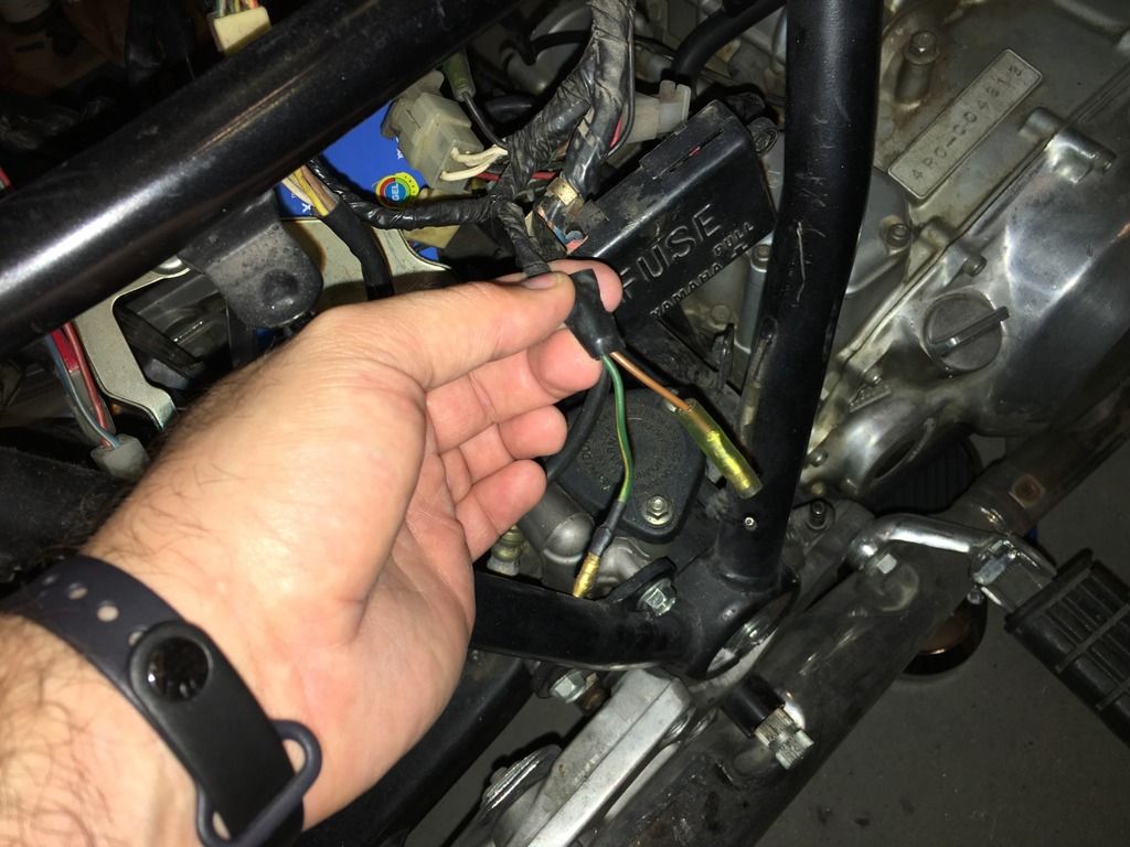

I appreciate it, I tore my bike down to the frame and left it like that for over a year cause other stuff got in the way, as far as the front and rear brake wire harnesses can you upload a picture so I can see what they look like? Also I have a two wire harness that is black and black / white out the front with one green end that is connected and the other end has a butt on it. Do you know where that goes? Again, pictures would be a huge help81 SHComment
Okay, the black and black/white wires are for the Emergency Stop/Run switch, according to the wiring diagram.
As to the brake switch harness photos...you have them for the rear, first is the actual switch, the second is of the harness wires that should plug into it.
The Front brake has a switch/wire that is part of the front caliper, you will need to trace it down from the handlebar into the headlight bucket and harness area.

actually
after looking at your last picture, that looks like the leads for your rear brake light indicator.mack
