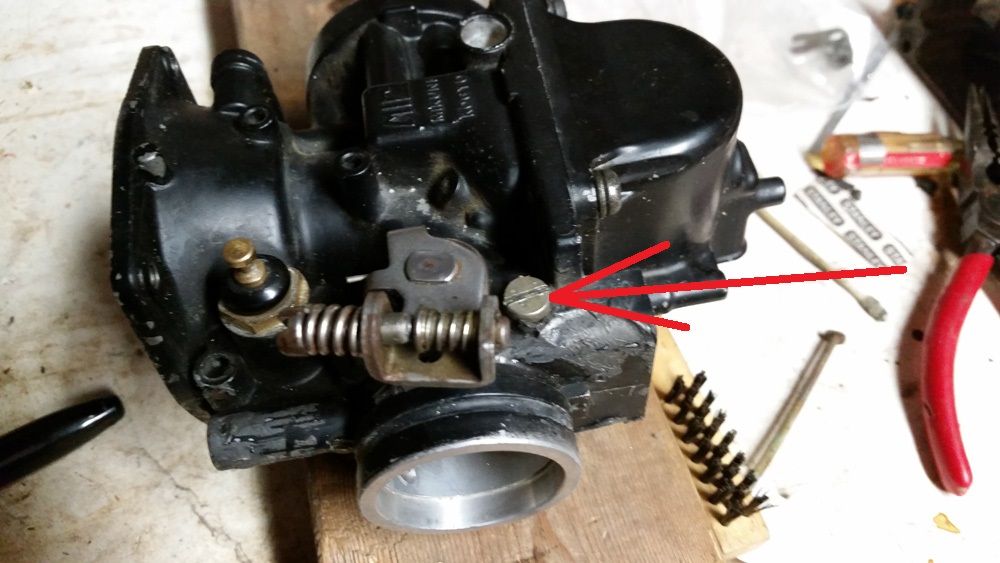

    On the carb what is the brass screw below the butterfly spring for? It looks like it’s just a detent for the spring. The older carbs don’t have it.

    Brass screw on carb
    On the carb what is the brass screw below the butterfly spring for? Below the throttle linkage.

          Screws
          The brass screw is a retainer for the spring.

            This screw?
            No idea what that is there for.
              • 9980
              Some carbs have 1, some have 2, and some have none. I puzzled over those for a while too but they seem to have nothing to do with the operation of the carb.
              Could be those carbs are used on some other bike and that serves a purpose on another application.
