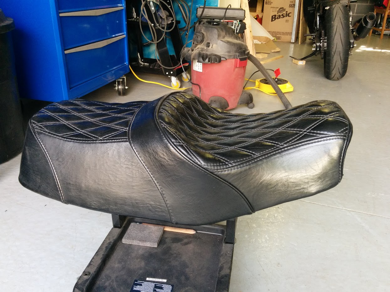

            For those interested in parts, can someone tell me if this is the stock 79 Special seat? The previous owner told me this was an aftermarket seat or something, but I can't tell. It's in good condition but may not be original.

              I would think those lowering spacers may be making the noise you are describing, they are free to float around and slam up against the damping rod. It can be very volatile inside the fork with the fluid being forced thru damping holes. It shouldn't be a concern regarding functionability. If the spacers were fixed in position and not free floating, that may cure your 'click'.
              The seat you have pictured is a Yamaha factory touring seat, not the original that usually came with your 79SF.
