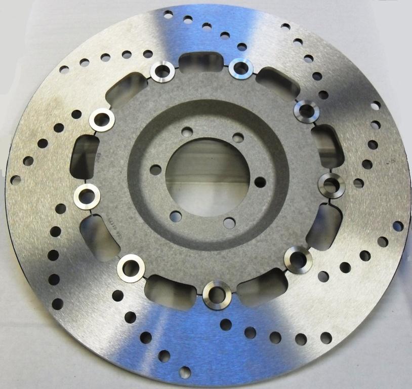

    I believe this is the rotor on the bike pictured at the top of the page. It's an EBC rotor that weighs in at 4 lbs 4 oz. That saves five pounds of unsprung weight off the front axle!
    Here's a 3 lb 6 oz Brembo rotor that is available for the XS1100.

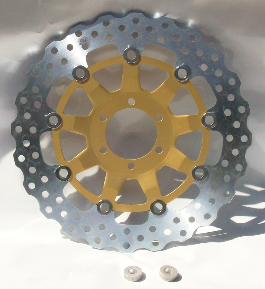

    This EBC rotor weighs just 2 lbs 15 oz.
    Use of these rotors will likely involve spacers and different pad compounds, the latter more easily found for the standard than the Special. It's also going to take lots of love because these upgrades don't come cheap.
