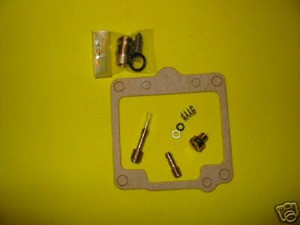

    How damaged? If it was just the screwdriver slot, that's easily fixable.
    Grind top of mix screw flat, Dremel a new slot across top.
      These should work
      However you have to buy the whole kit. He sells them in packs of four and the price is not that bad. You probably would want to replace the o rings anyway.
      I would just clean most of the original parts and reuse those and maybe just use the idle mixture screws and possibly the float needles if needed. The rest can be easily cleaned.

        Mixture screw for your '80 on ebay....
        http://www.ebay.com/itm/YAMAHA-XS110...5af2c2&vxp=mtr
          Grab
          All 4 so that you can get the o rings too.

            Thanks for the speedy replies....and thanks for the links....
            I ended up buying just one on eBay...I already had ordered the new washers and o-rings...
