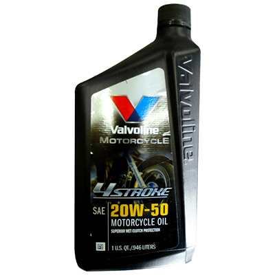

                    For what it's worth, I've found only a few places to sell 20W-50 oil, and usually Walmart had it cheapest. Not sure what's in the bike currently, but I've bought Valvoline, Walmart Supertech, and Castrol GTX in that viscosity from there. Did run Rotella T5 last year and had clutch slippage.

                      AutoZone or O'Reilly Auto Parts will also carry conventional 20W-50 oil, in various brands ...
                      Valvoline, Castrol GTX, Pennzoil, Quaker State ...
                      Personally, out of those four, I would go with either the Castrol or the Valvoline.

                        Autozone and Advance auto parts carry conventional motorcycle oil in 20W50. They seem to always have Castrol and/or Valvoline.

                          My Local Walmart didn't carry the Castrol GTX 20/50 during the winter months, but now that's it's spring almost summer, they have it back in stock, so it may be a seasonal thing? Just stock up in the fall for the next year!
