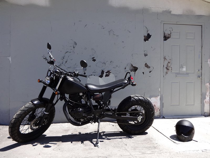

                      Now, on to riding. Like I said above, I am basically a new rider. I only got into bikes in the last couple years. I've always liked motorcycles, but I was never compelled to own one until I took a trip to Japan and saw the modded Yamaha TW200s over there. For whatever reason, I fell in love with these, and ended up putting one together in 2012. I started with this:
                      And ended up with this:
                      So I have been riding my little TW around for the last 2 years, and I really enjoy it. I am more of a casual rider. I ride when I feel like it, and I am very conservative and defensive. I'm 38 years old now, and all my "dumb ass" years are behind me, for the most part.
                      Now, obviously, my TW is a small bike. I can basically pick it up on one end and shimmy it around without issue. I understand the XS11 is a much bigger, heavier, more intense bike. I've done some reading about handling, that was somewhat off putting, but I would imagine like anything else, it just takes some practice and seat time to get to know the machine you are on.
                      One of the main reasons I am looking for another bike is I would like to be able to comfortably ride on the freeway, and I would like a bike big enough to ride 2-up with my wife.

                            The modified bike in the pic looks great, I reckon, and so much more individual than the standard factory bike.

                            Ps. Some people say my XJR looks like a wasp. Well, your bike reminds me very much of an ant.....
