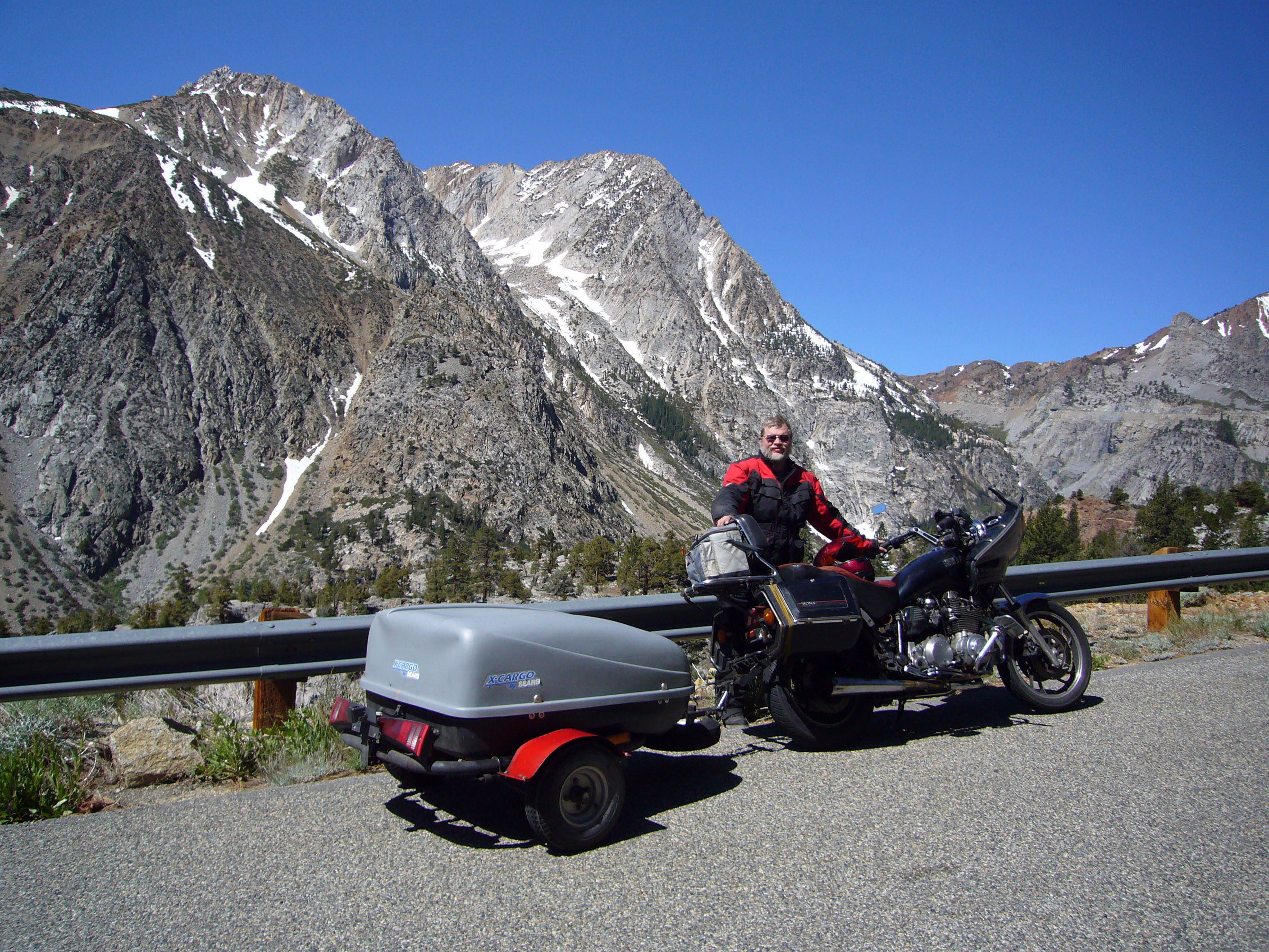

            I pull a home-built trailer. Pulled it with the XJ for years, now pull it with the Connie. Here is a photo (2008) of the XJ and trailer entering Yosemite National Park:
            Pros: Carry more which makes for more comfortable camping.
            Cons: Lowers MPG by a couple points, takes slightly different lines through curves.
            I built my own hitch for the XJ, bought one (Hitch Doc) for the Concours. Other threads can offer ideas on how to build an XS - XJ hitch as several approaches have been taken by different owners.

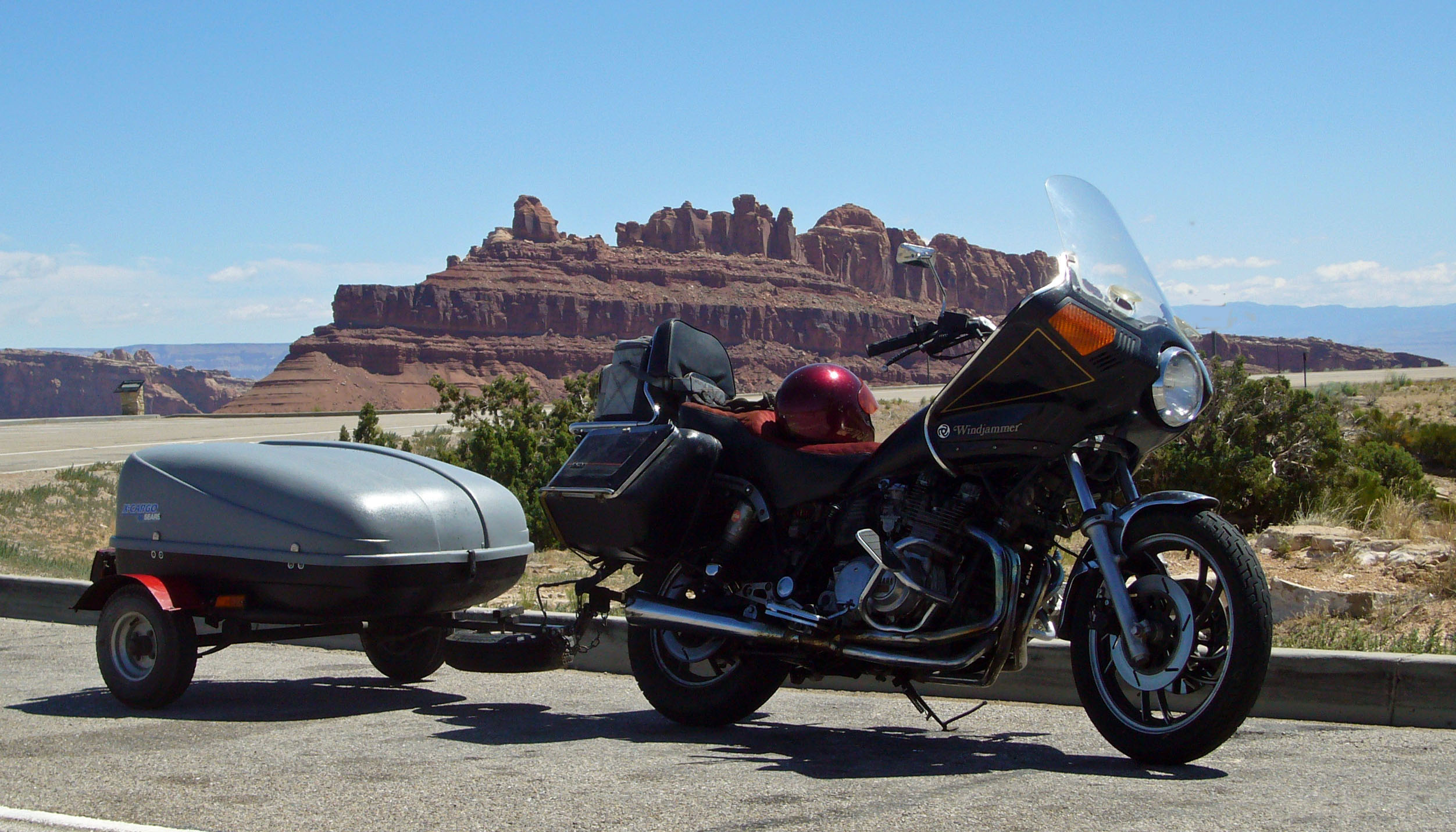

                    The decison on if to pull a trailer or not depends on if you want to camp, and if so, what level of comfort you want to have.
                    Many people carry a small, 1-man tent and sleeping bag and do not need a trailer. Advantage is less weight, items can be used as a backrest, and everything will fit on the bike. I started out camping this way but never liked the higher center of gravity that packing all the stuff on the bike gave me.
                    As I got older I wanted a higher level of comfort. I carry a tent large enough to stand up in, a folding chair, Coleman 2-burner stove, food, air mattress, extra clothing, and other creature comforts. Generlly I ride to a destination and stay there several days so this works out well for me. Set up once and take down once. When I do set up for one night I just pull the tent and go out for food. Easier to repack and get going in the morning.
                    If you trailer you should not exceed the bike's GVW rating. For me this meant keeping the weight of trailer, loaded, to under 200 pounds. I also upgraded my brake lines to stainless steel units. I did get an oil cooler but never got around to installing it. I had no heating problems when trailering with the XJ even when I lived in Arizona.
                    Trailering with a bike is not an exact science. I found a litle more tongue weight to be an advantage, generally about 15 - 20 percent of the trailer's weight is recommended. For a 200 pound trailer this works out to about 30 - 40 pounds. Originally my trailer had to little tongue weight so I moved the spare tire forward on the tongue to compensate. I pack the heavier items forward of the axle as well. This arrangment gives me good handling. I also used smaller tires on the trailer which keeps the tongue is in line with the rear axle when I am on the bike. This keeps the trailer's center of gravity low. Yes, you do need to get used to the trailer's weight for acceleration and braking, but after a few hundred miles this comes naturally.
                    I like having the extra capacity and feel it makes my camping trips a lot more enjoyable. For that I put up with the lower fuel economy, greater rear tire wear, and having to take slightly different lines through curves.
                    (XJ and trailer in Dragon's Head rest area - Utah - heading for California coast.)

                    I had started out carrying a cooler on the tongue of the trailer but after a year I removed it and went to the small grey cooler you see on the XJ's luggage rack in the rest area photo. Plenty of capacity for me as I travel solo. 7 - 8 pounds of ice keeps beverages cold all day.
