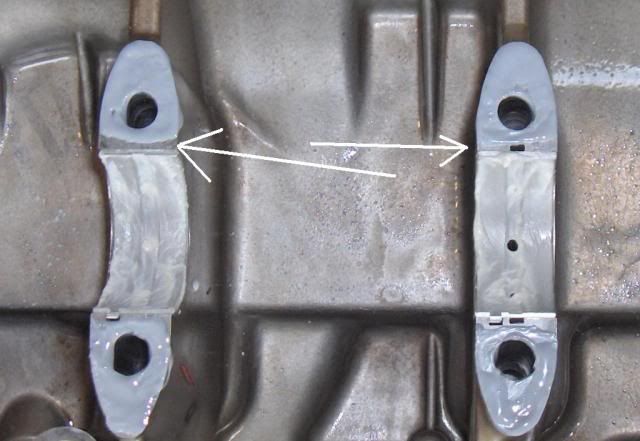

          I just kind of smear it around using the tube. Both it and the Tribond stuff flows really well and flattens out on its own. Gotta be fairly quick though, the stuff starts to skin over and dry pretty fast. And as stated, leave a gap by the crank bearings, but make sure and get around the bolt holes like this...

            Sounds like a finger will do the trick though. I have enough cuts already, a few more will not matter. I see from Tod's pic application to the lower case half perhaps the smartest way to do it.

              I've tried using my finger before, but I just ended up making a mess. When you stick your finger to it, then pull it away, you get fine spiderweb-like strands going everywhere. I just put the tube opening onto the case and as I lightly squeeze, just kind of use the tube like a big pen. It flows out level.
              When you go to set the bottom shell to the top one, if it doesn't want to quite seat, wiggle the gears just a touch and it should drop right together.
