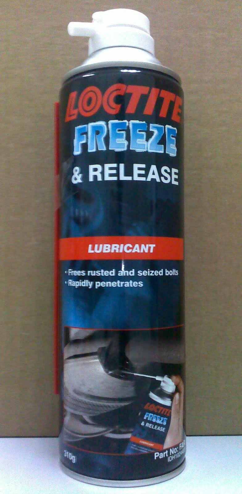

      James- I've used several fool-proof methods including heating the head with a torch, and quenching the stud with a rag and unscrewing, there is the heat and wax method, and my final weapon:
      Loctite Freeze & Release. We used variants of this in the electronics field for troubleshooting (freeze spray). CRC makes it as well. It has gotten me out of tons of binds, and my next-door neighbor is the Vice President of Muffler Man, so I get an endless supply of good stuff for free. In a pinch, turn a can of air duster upside down.
