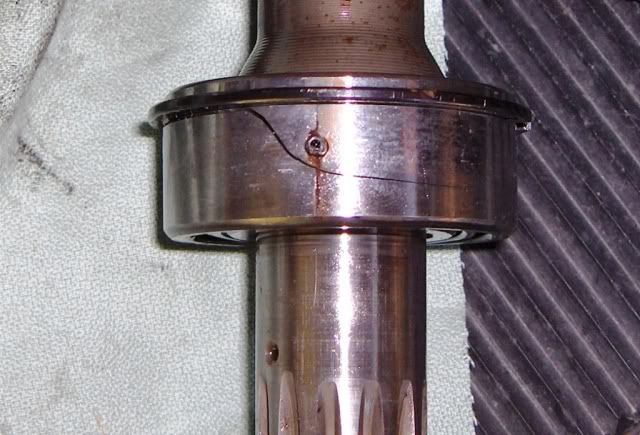

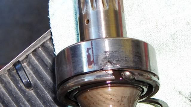

                      The right-hand transmission case, output shaft snap-ring, bearing, and the precision-ground cast iron 3mm shim. The shim is beveled. The narrow side seats against the outer bearing race and the wide side seats against the aluminum case.
                      The bearing and case show discoloration from heat and light scoring from the bearing beginning to turn in the bore.
                      The 'special' flanged bolt is not shown but it has a precision ground 3mm steel shim so the KOYO 6205SZ single-row ball bearing substituted for the 4205 double-row ball bearing requires 6mm of shims to keep the gear stack aligned correctly in the transmission case.

                      The pinned and ringed double-row ball bearing has a lot of bluing at multiple hot spots on the outside of the outer bearing race but no scoring or scuffing from movement. The bearing is an NTN bearing but I can't read the number without removing the clutch.
                      The aluminum case is not shown but aside from being shattered into several pieces from the wreck the bearing bore has no damage from heat or bearing movement.

                              Yes, Tod, THAT bearing!
                              The bearing in this engine has large and small light blue and deep blue spots all over it at various points around the outer race in roughly two 'tracks' that follow the two internal bearing grooves. The colors don't photograph very well and I had to angle the camera over the clutch basket so the light wouldn't completely wash out all of the colors and make the bearing look like a normal steel bearing with light reflecting off of it.
