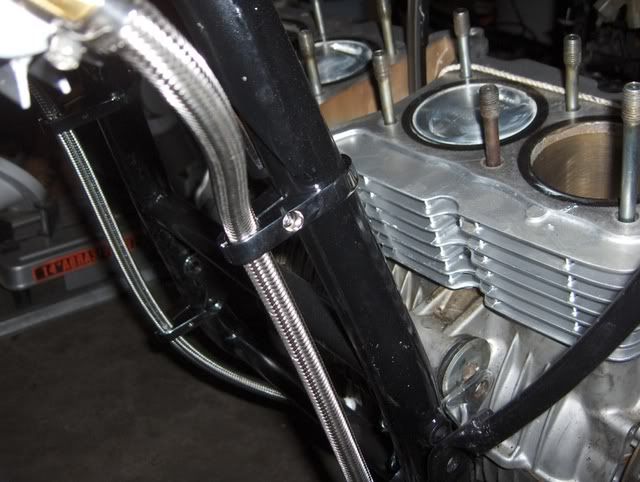

                I have a different radiator now.. this one bashed my front fender into submission from wheelies.. but my lines are run out in front of the frame. They do get next to a pipe at the bottom, but for the most part, they're out in the open.. so I'd have to say the answer is.. Oil.
                They're held in place with clamps.

                  Nice looking installation.

                    Where did the clamps come from Tod?
                      Had to ask, didn't ya? lol. They were saved in my favorites from another computer. I think I saved them... I'll look tomorrow. Found them listed on a site with a bunch of Harley farkles...
                        They aren't cheap if you buy 4 of them, but I've found that just two (One on each line) will work mounted somewhere in the middle between the attachment points to the adapter and the radiator.
                              http://www.westendmotorsports.com/ku...rs-p-1392.html
                              ¿Where'd you get the lines?
