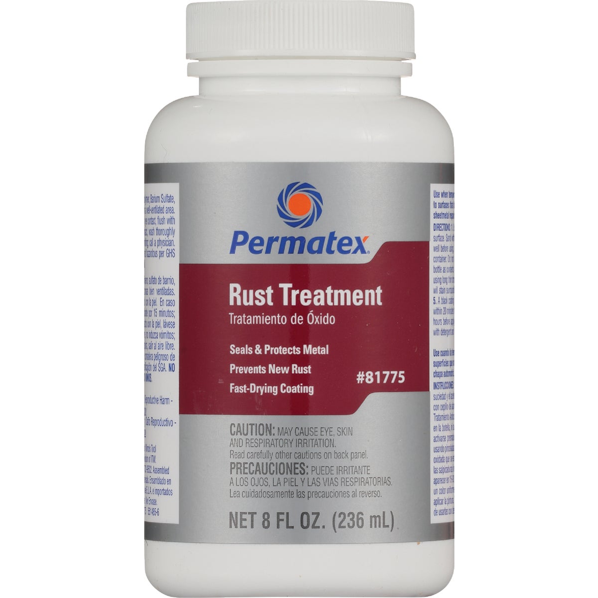

              Treat the rust on that pan and repaint it. No one will see it. I use this to encapsulate the rust, so it's gone forever.
                I need to check the pan out good because I think some spots rusted completely through and the pan was just flaking off in some spots. But if it's not near a corner and just "break" off maybe I can fix it.
