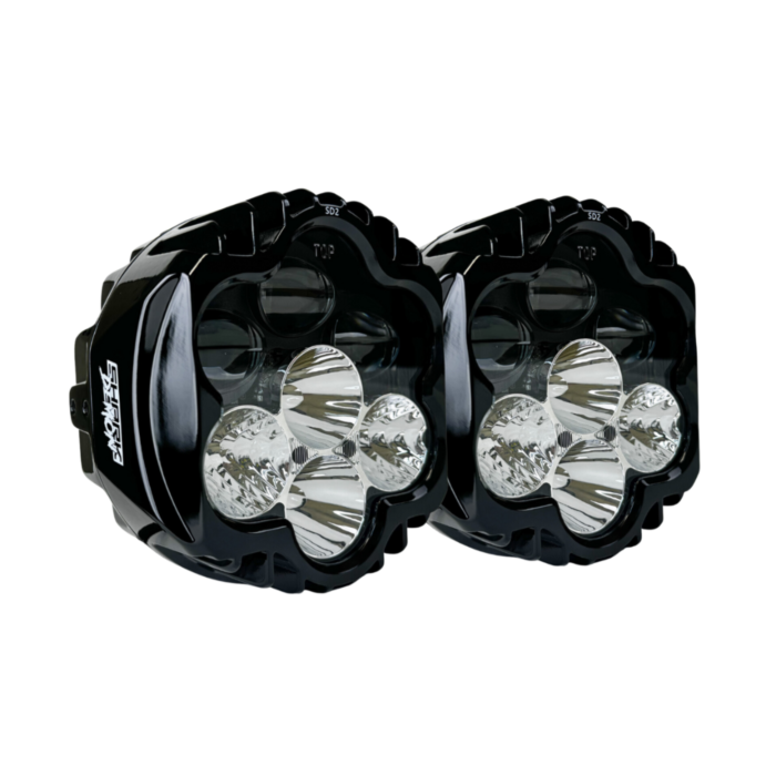

                  Aside from the Clearwater daytime running lights ( >$400 ), there are these headlights...
                  Shop premium LED motorcycle headlights and passing lamps for Harley-Davidson and Indian motorcycles. Explore Shark Demon, ProBEAM, TruBEAM and more.
                  4.5Amp (High Beam), 2.5Amp (Low Beam)
                  @approx 12 - 14 volts that would be minimum 54/30 watts, right?
                  I can't remember the rated wattage for our stock headlights.

                    For the halogens, that's 60/55 watts
                    I dunno about working out the light output from the amps stated in the ad for that headlight. Doing just a straight amps x volts calc doesn't work with these new light systems.
                    Mind you, my 50 watt HID pumps out an enormous amount of light so they might be on a different scale for those things. I didn't see any mention of the word "Lumens" on that site. That'd be the tell-all.

                                It does say it meets DOT standards which do include minimums and maximums on area lit up when installed. However, at almost $300 for just a couple hundred more you can have a DOT legal HID system which I'm sure is even brighter and lower draw. It might not last as long, but HID just has more cool factor (or may LED has the cool factor now). Now, as to where it falls in the DOT standards as far as brightness? That's a good question. That said, it IS lower wattage than the stock bulb, and it IS solid state which is always a good thing (ok, almost always), it's LED which has a cool factor all it's own, and it's the right size. And from what I can see, unlike the DOT HID system, you don't have to cut a hole in the back of the bucket for the back part of the unit (drawback is that neither of those units are made for the standards square headlight, only the round headlight of the specials, or aftermarkets fairings like mine ).
