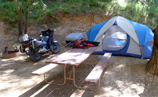

        I used my trailer over the 4th of July weekend for the Colorado Rally. Also used it this year at the Santa Mararita (California) rally, see photo below. Pulled it around 2,300 miles all told so far this year.
        Crazy Steve is correct on the weight. I built my trailer because the commercial ones I saw were to heavy, IMHO, including the basic trailer frames available from Harbor Freight and other outlets. Empty weight, with spare and jack, is about 120 and loaded is near 180 if I take everything, including 2-burner camp stove, food, water, and folding chair. Basic kit, which I had in Durango for the rally, comes in closer to 150 -160, as it it only the tent, air mattress, clothing, and sleeping bag. I'm looking at getting a JetBoil to replace the Coleman stove and a self-inflating mattress to replace the air mattress. Both would cut the weight by a few more pounds.
        In my case, I feel the trade-offs (including decreased gas mileage and increased tire wear) are worth it to have a larger tent, more clothing, more comfortable matteress that one typically hauls without a trailer. I like a tent I can stand up in to change gear or get dressed. Not essential - ask any rider who camps out with his/her bike - but nice to have if you want it. Same with a folding chair and hatchet, both part of my full kit. I've had campfires in remote locations a couple times because of the hatchet, and sat around them in my folding chair.
        Like any other piece of equipment, you need to determine what it is you want to carry that you could not or would rather not carry on the bike, and how essential those items are.
